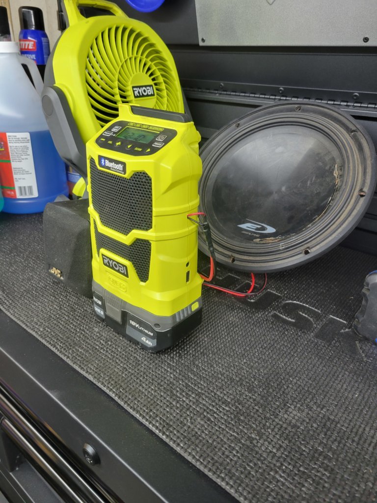

    First off, yes it's Friday, but this isn't completely a joke. I have a ryobi radio that blew the speaker and decided to modify it to work rather than buy a new one. Had an old JBL speaker to hook it up to, and we pulled a janky Alpine Type E sub out of the drift car. Currently that sub is wired straight inline, so looking for a small Amp I could place inline. Any suggestions? :rofl:
    I have usb or 3 prong power options.

    Dedicated to just the sub. Something cheap, just enough to drive the thing above regular speaker level, but maybe with a filter built in to prevent clipping. Something in the realm of $30 or less ideally. Not looking to run a full 1000w Amp or something.
    The Bluetooth portion and regular speaker portion runs on the batteries, but it would drain it to tie the sub to those. But you're the resident expert sounds like. The tool box it's on has a power strip built in with the standard 3 prong and 12v usb.

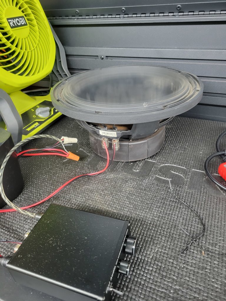

    Looks like whatever I do I'll have to splice an aux cable into the radio output. Right now I'm just running red and black out from the original speaker line.
    68w, and I wish it showed the back of the unit.
    Looks like they accept speaker level since the add-on item is RCA to Line, without diving into the details.
    What about this? https://www.amazon.com/Subwoofer-Amplifier-Receiver-Integrated-Audio/dp/B07942M4MC/
    Looks to be all in one and RCA input, so I could splice one cable out, tie it into the ryobi, then run mono input to the amp. Since the ryobi radio is only Mono technically, only one speaker, then I won't need both RCAs correct? Or should I splice both together and run it that way? budget tossed aside since I'd rather not piecemeal if I don't have to.

    yes, that fosi audio amp would work. the only concern is going to be the input level. the radio 'should' output low enough that it's not a problem, but there's no knowing until you try.
    you'll only need to connect one of the rca's to get the audio into it. it should be a summing amp, meaning that it takes R+L audio signals and adds them to each other for a single output.

    Ordered. Will update with results! Thanks for the help fellas.
