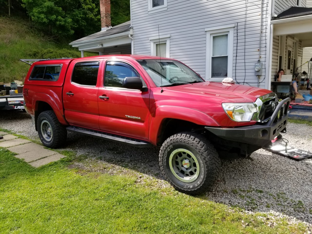

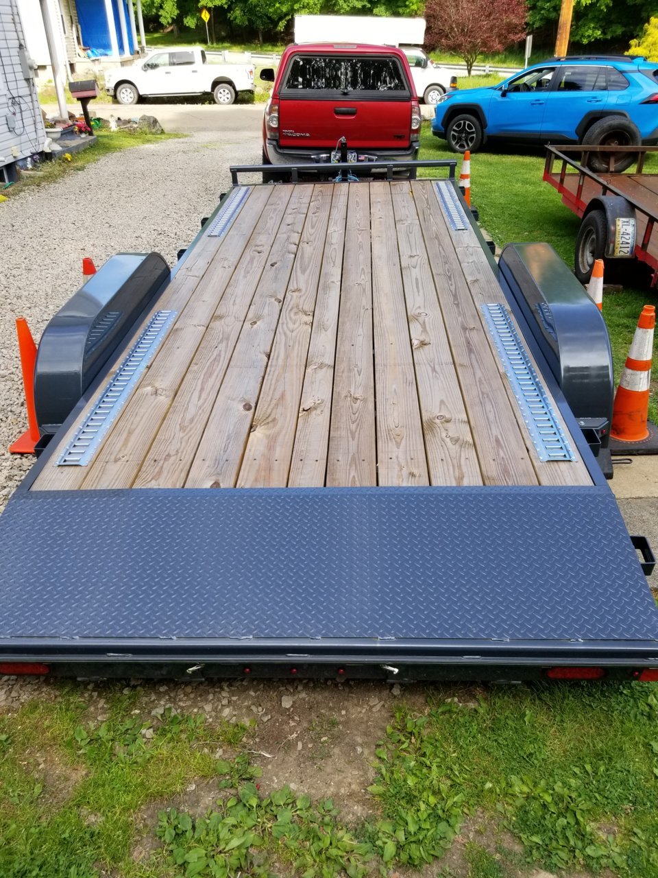

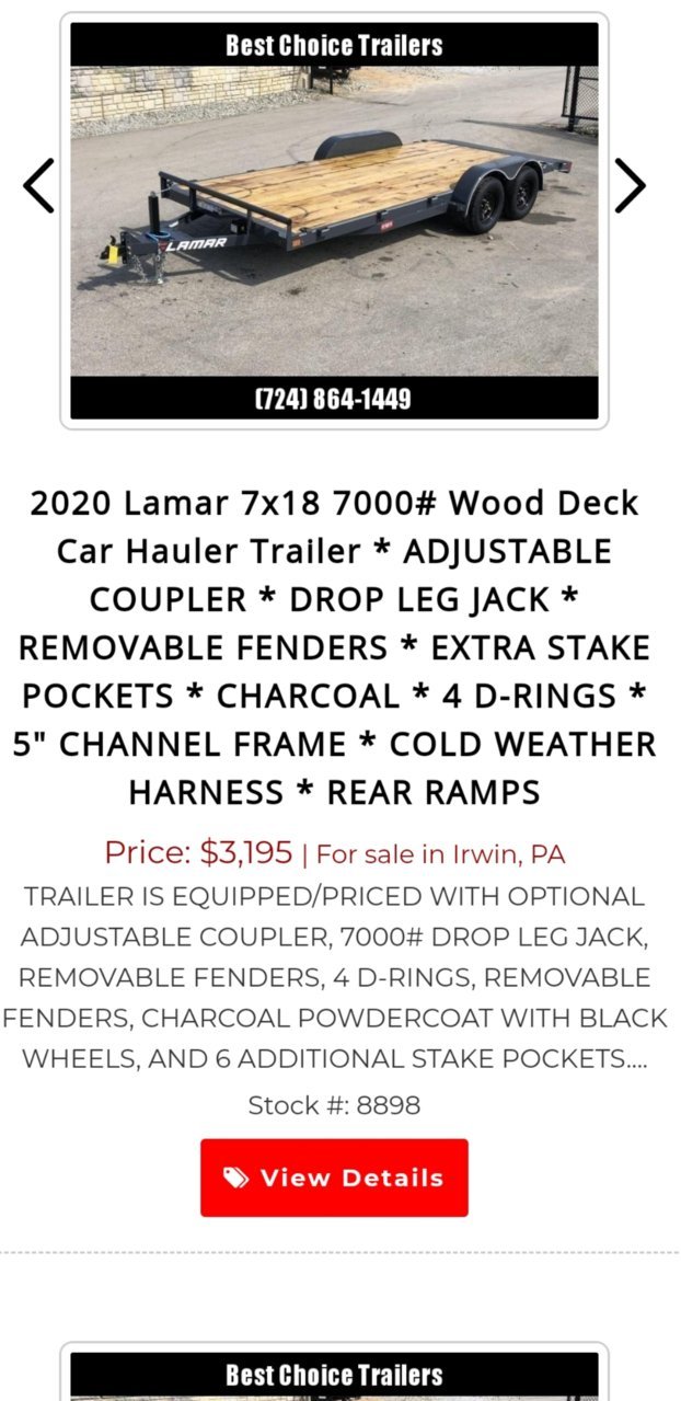

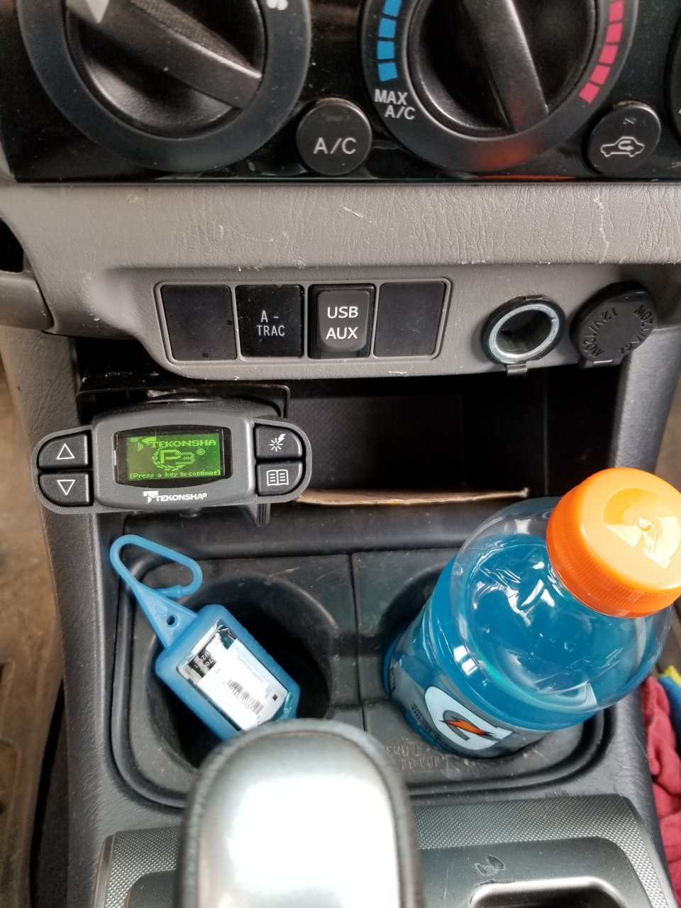

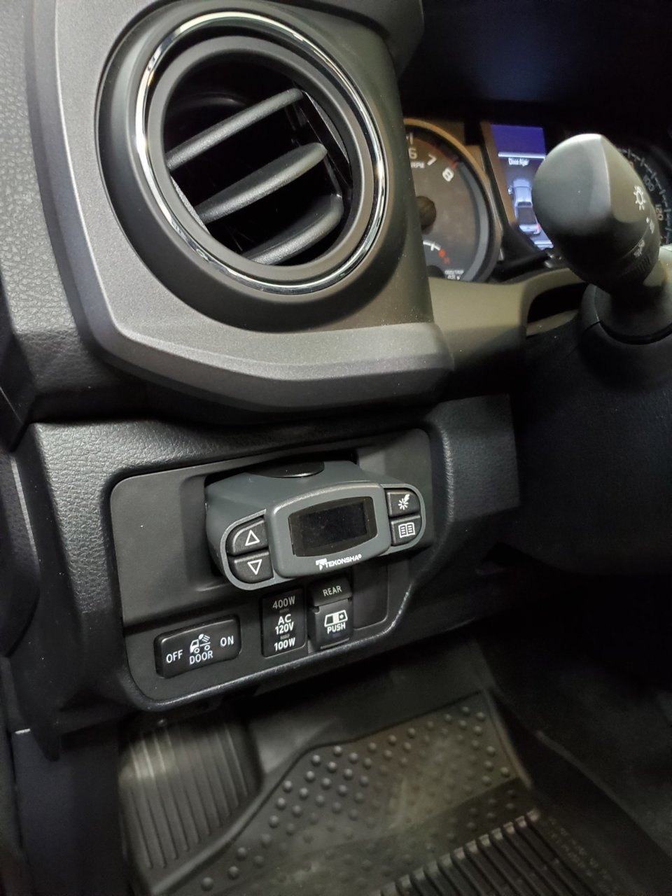

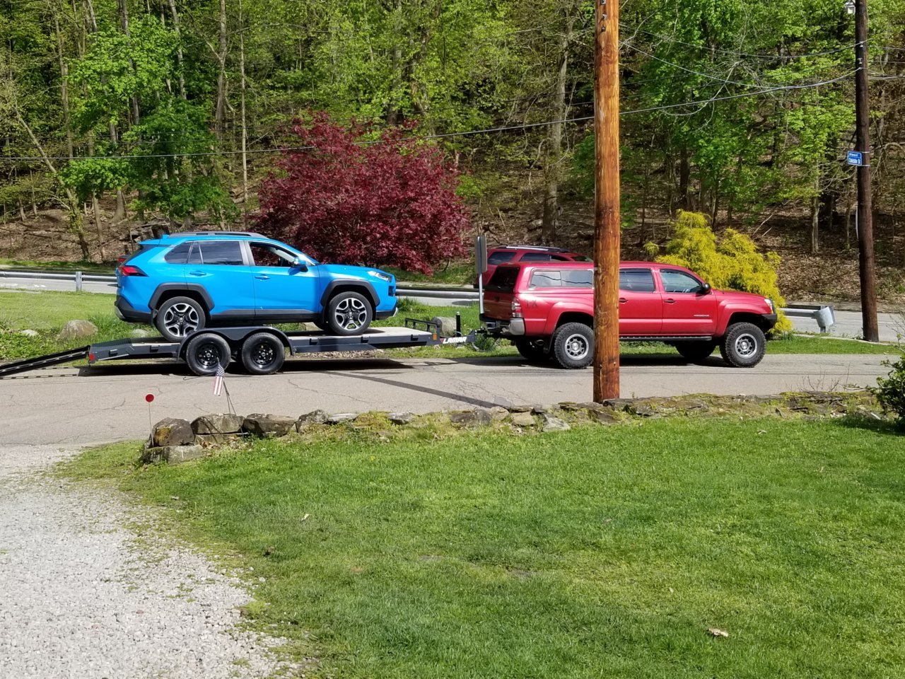

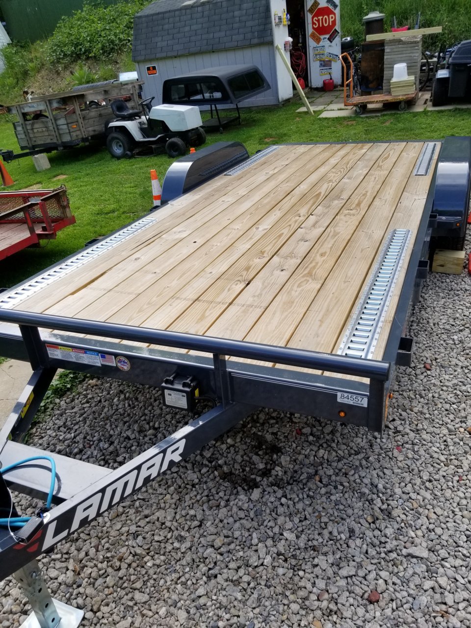

    Edit Update: Bought this 18ft LAMAR car hauler which is 2,150lbs. Was going to get a tandem axle utility trailer but for the price, weight and uses I chose to just get a car hauler. My truck is a 2013 Tacoma dcsb 4.0 auto, OME 886's with Bilstein5100's set at zero for 3"lift up front, Bilstein 5100's rear, stock springs (overload removed) with Wheelers 3 leaf ad a leafs, Firestone ride rite airbags with daystar cradles and 265/75/16 load range E Cooper ST Maxx.
    I ended up buying the Tekonsha Prodigy P3 with Tacoma specific harness. Just added E track strips to the deck. Winch and stake sides are next along with spare tire mount.

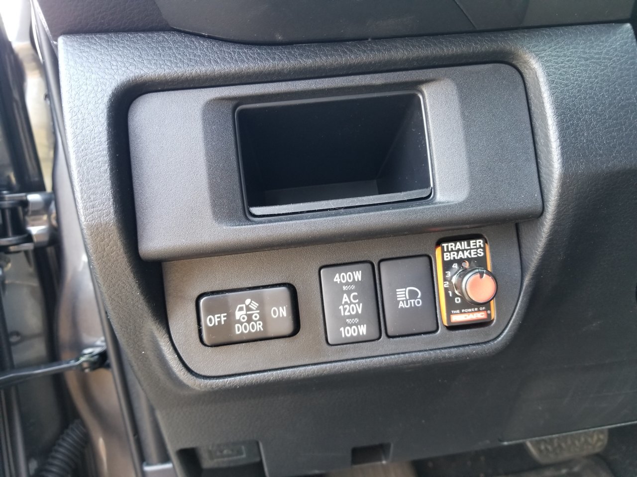

    Tekonsha P3 controller FTW!
    https://www.amazon.com/gp/product/B000P17NXQ/ref=ppx_yo_dt_b_asin_title_o01_s00?ie=UTF8&psc=1
    Here's the associated Tekonsha 3017 wiring harness:
    https://www.amazon.com/gp/product/B004R33UH6/ref=ppx_yo_dt_b_asin_title_o00_s00?ie=UTF8&psc=1
    I have this in my 2017 and it works great! Easy install. I placed the controller right in the left hand cubby. For you 2020 folks without the cubby you'll need to use the included mounting hardware to screw it into the plastic panel underneath. It's a bit more than other controllers but IMO well worth it.

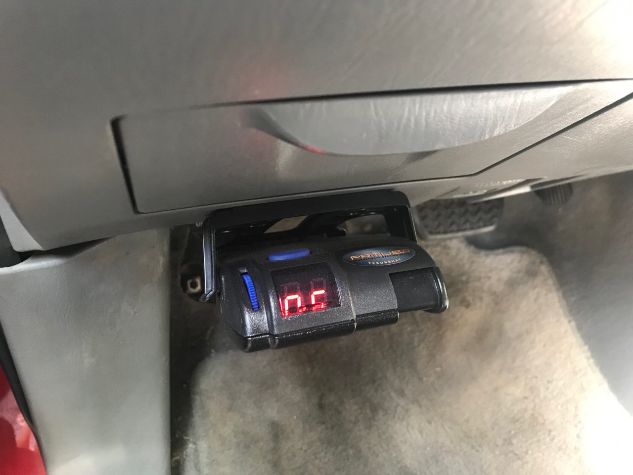

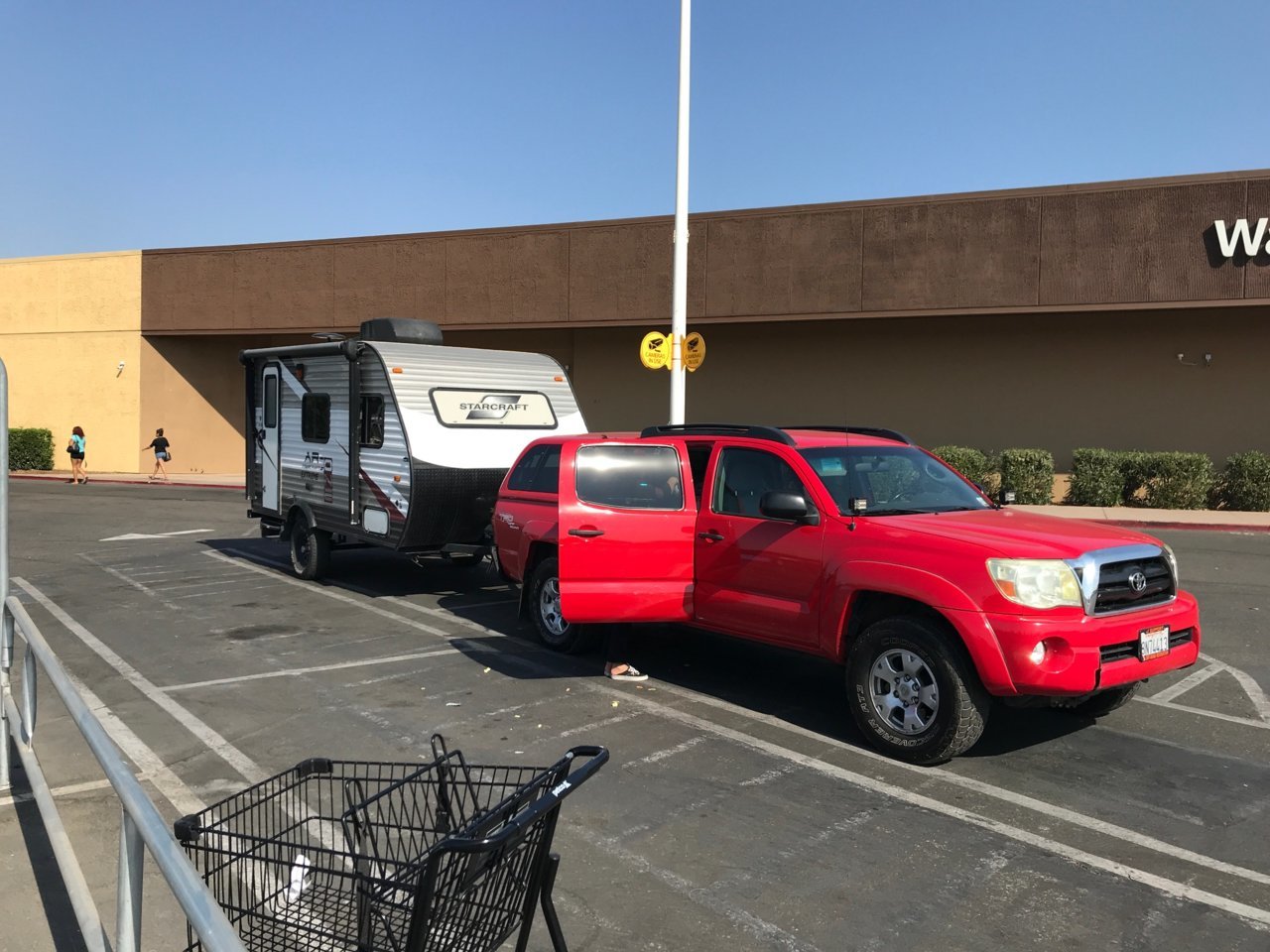

    IMG_2313.jpg IMG_2314.jpg 59243599474__3EE34462-84DA-4820-91DC-E656181A729A (1).jpg
    I use the Tekonsha Primus IQ, pulling travel trailers between 3-4K lbs. It has an inertia sensor, smart brake boost, etc. etc. I pulled this trailer up and down California, up to Yosemite and down again with no issues. It was very easy to set up and get going, and adjust along the way.
    I also bought a 2nd Gen Tacoma specific harness along with it (both off Amazon) which made it 100% plug and play with the tow package.
