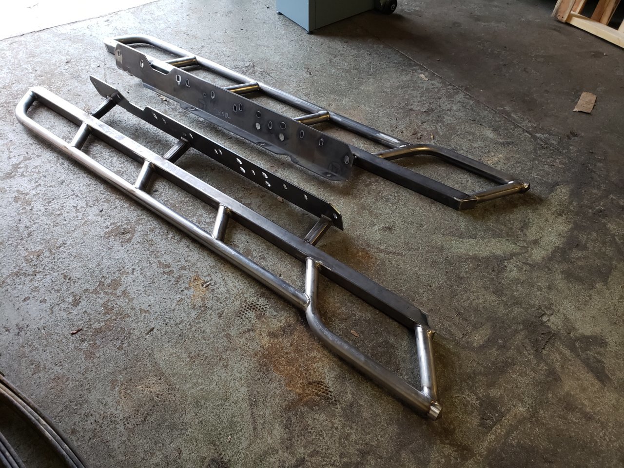

  14. Dec 17, 2018 at 11:33 PM
    WormSquirts
    WormSquirts Armageddon
    Dec 18, 2015
    #172583
    2,489
    Braeden
    BC
    These are ours made in house! These specific ones are dcsb
    We also have the caliraised sliders in stock
    blqchclt and TeecoTaco like this.

  16. Dec 27, 2018 at 10:55 AM
    #16
    Spackletooms
    Spackletooms Well-Known Member
    Dec 2, 2018
    #274536
    78
    BC, Canada
    2017 Tacoma TRD Sport
    Looks good! How much for a powdercoated set?
