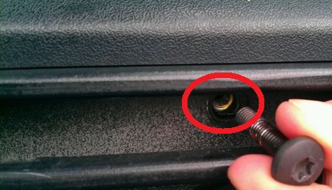

    Ive been looking to find the nut plate that holds the screw for the bed rail system. Cannot seem to find it. I broke the screw inside the nut plate, drilled it out, and damaged the nutplate in the process, and need a new one. Thanks guys!

    I'm sure if you found out the threading you could goto a local hardware store and get one, or Amazon

    Salvage yard is where I found some. Might as well get the screws also.

    I Went to the dealer and they said you can't get them individually, it's part of the bed panel. I didnt have any Tacomas in my local junk yards. So I went to lowes and got a washer and locking nut for the M6X1.00 bolt, and locked the rail in that. Couple of bucks and it works. I was just wanting to use the original nutplate, but hey, this works too. Thanks, Guys.
