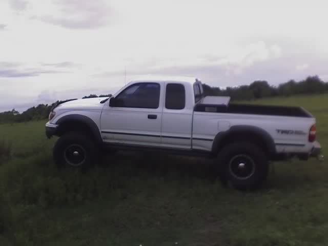

    05 SR5, 3" suspension, 3" body, 285/75-16 Nitto Grapplers
    Here's mine with a 3" body and the Revtek spacer kit running 285's. No rubbing at all, no issues with alignment.

    thanks for the pic, do you have anymore, maybe ones all around and more lower, i want to see if i can see the frame stick out anywhere and also what it looks like in the front. thanks did u do the body lift first?

    I'll see if I can get some more pics (but we are having super shitty weather here right now, so it might be a while). You really don't see the frame sticking out too much. I now have N-Fab bars on there with the 3" main tube and it covers it up a good bit. I actually bought the truck the way it sits, so I can't attest to what it looked like with just the body lift.
