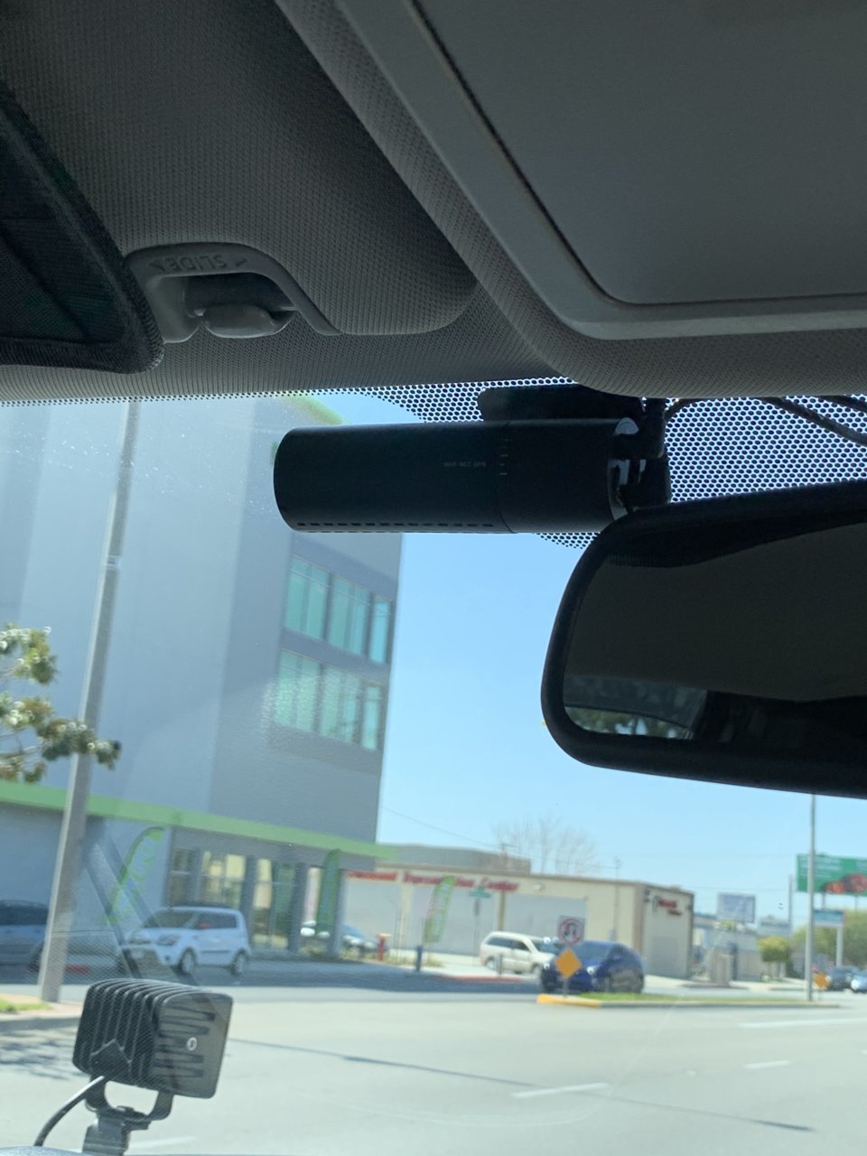

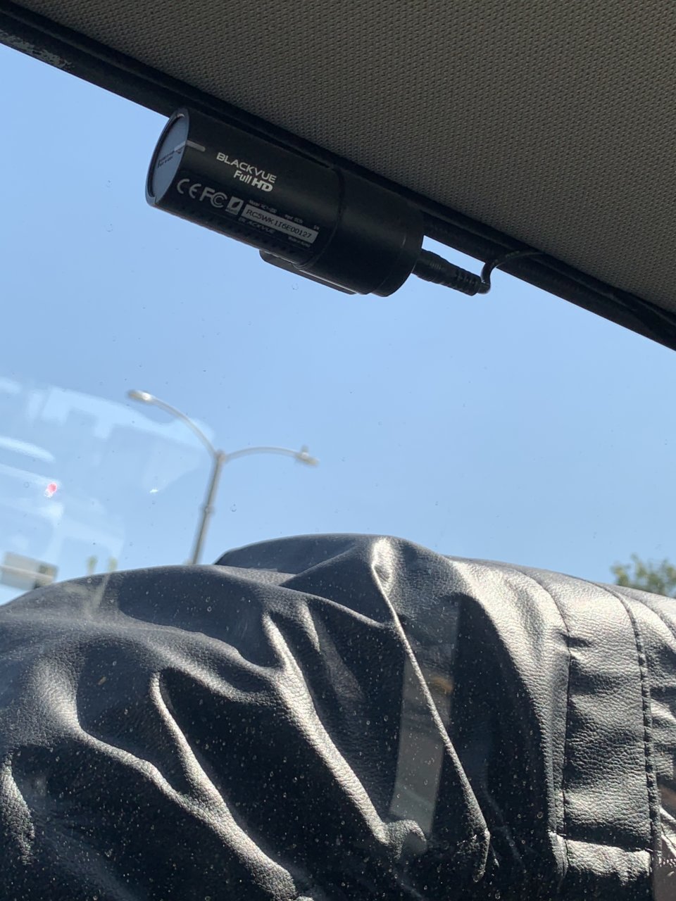

    Rear tint doesn’t have an effects on the vid. I have 20% tint.720E49C7-FB5E-44AD-8593-DF3C6989E3EE.jpgAC0B9866-5093-4F3A-8511-C38FD3567FA1.jpg
