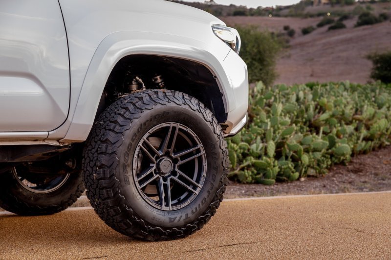

    Hello forum.
    The mediocrity of the stock wheels on my ’18 sport has finally begun to weigh on me to the point I’m ready to do something about it.
    After much travel, through many internets, I’ve landed on the following rim, specifically, due to aesthetics and weight. It seems it’s relatively new to the market, making feedback almost non-existent. So, to the guys that know they’re way around a wheel, I ask.. Is there’s any reason, WHY NOT the following rim.
    Vorsteiner (parent company?)
    Venomrex VR-602 TUNGSTEN GRAPHITE 17” X 9 ” -12 offset
    https://venomrex.com/collections/wheels/products/vr-602-tungsten-graphite?variant=12409143591001
    They’re lug-centric rather than hub, and specifically warn against using rings to make it so.
    This, in and of itself doesn’t give me much cause for concern, but I’m interested in any input on the subject. I’ll be running the stock sport size (265/65/17) Nitto Ridge Grapplers that are currently on the truck.
    Looks like this will be the outcome, coming off the stock 17” X 7.5” TRD sport rim.
    The Venomrex wheels will have an inner rim which is 1.1mm closer to the suspension strut. The outer rim will protrude out 37.1mm more than before (1.46 inches) (I think the latter is about what I’m looking for, and will negate the need for the wheel spacers I’d previously been considering to augment the factory rims)
    Also, any reason I should, or should not expect the factory TPMS sensors to work in the wheels?
    Gonna pull the trigger on these Monday unless someone scares me off them.
    @mattylmber is the only forum member I’ve seen them with. Anyone else?
    TIA

    Rims look good. Don’t know anything about them, but they look good. I’d rather have the house in the background!

    Only thing I find odd is that they’re lug centric and they specially advise against using rings. I would at least email them and ask them why. Without them you could have trouble getting the wheels seated properly, introducing vibes

    Not being able to run a hubcentric spacer would be a deal breaker for me. That really limits the size of tire you can put on these. They do look go though, but I wouldn't buy them if you ever plan on running larger/wider tires or larger flares/fenders since you're going to run into clearance issues with the larger tires and it would look dumb if you couldn't fill out the fenders. It'd be great if they offered like a 0 or -15 offset as that would free up some backspacing.
