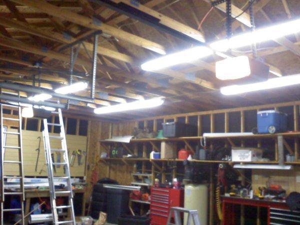

    youll probably need more or want more then 2 or 3. in my 2 car garage i have four four tube 2x4 fluorescent light fixtures, they are T8 daylight bulbs,they give a nice clear bright light.

    T8 is what i did. I put 3 fixtures in my oversized 2 car. 2 T8's per fixture. If your ceiling is white it will reflect a lot of light.
    Plenty of Light

    Thats very bright! I love that! Are those 5k bulbs or 6500k?

    Those look like 5k bulbs. 6.5k are too blue. The more lights you have the less shadows you will have.
