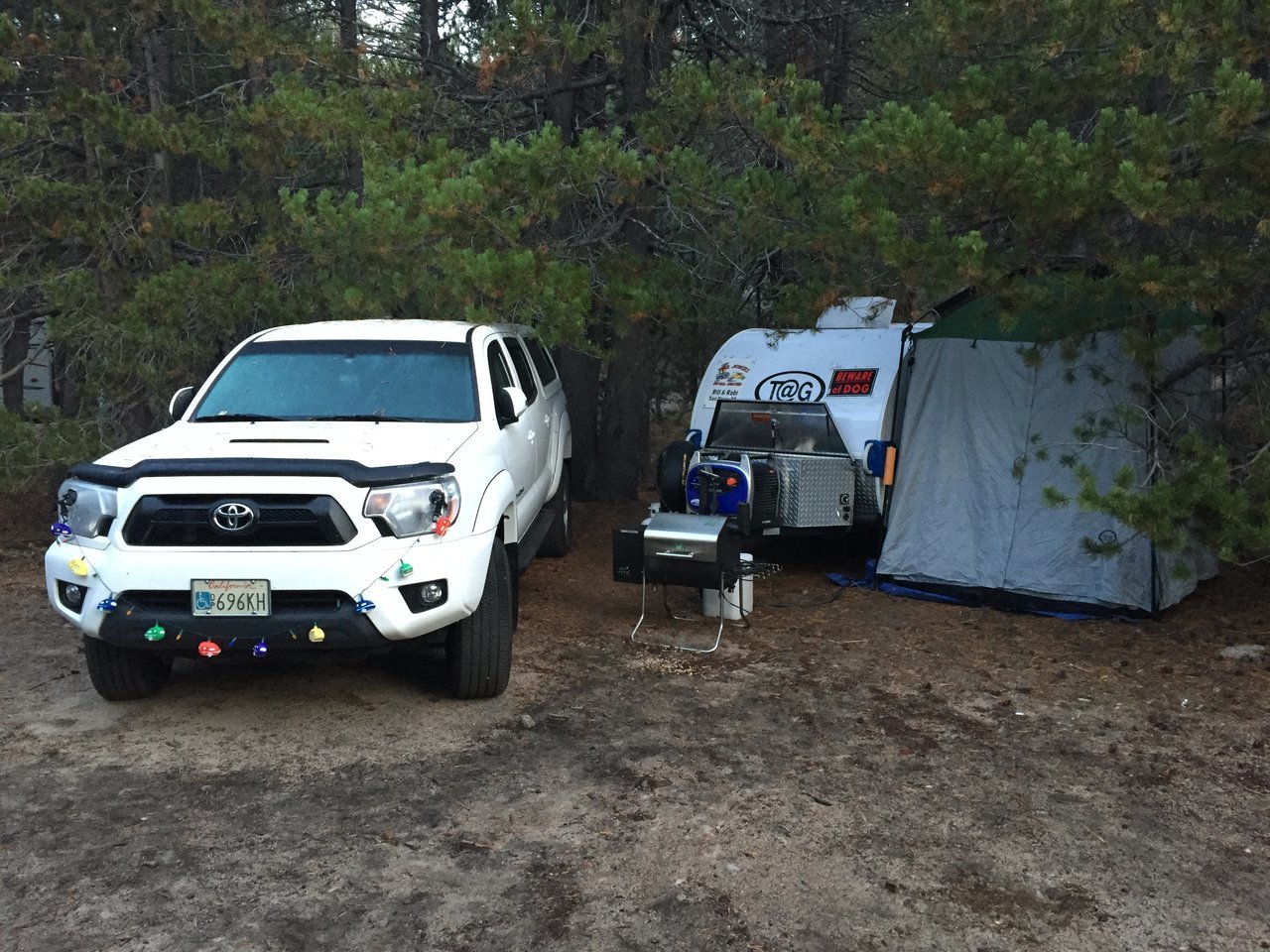

    Joe's T@G tows with a jeep - Jerry's home built tows with a wagon - Cuff's Rough Rider and Tacoma - ours

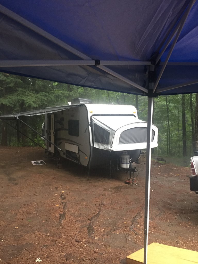

    IMG_4749.jpg2008 V6 SR5 auto ,no tow package. Added trans cooler and obviously the WD hitch . Just under 3000 with propane and battery.Probably load up about another 400 lbs of gear and firewood . I have no problem up steep grades 60-70 mph . Usually go around 100-160 miles to get where we are going .

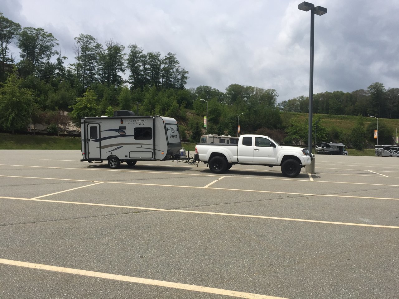

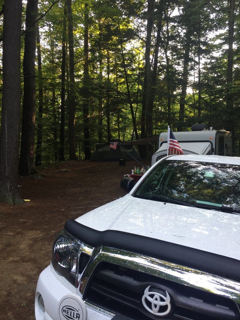

    I tow a Jayco X213 with a dry weight of 4,500 lbs in the Sierra Nevada mountains. It's right around 5,000 lbs loaded and we tow with a WD hitch. I have upgraded suspension and the tow package (but I did take several trips on the stock TRD Offroad suspension and it did okay...just a bit more bounce and would bottom out the rear on occasion).
    We pack most of our gear in the trailer to keep the truck weight down.
    I just installed an aftermarket B&M 70268 plate cooler for the transmission in-line with the small factory aux cooler but haven't towed yet to confirm temp drops (from what I've read from others here we should expect +20f cooler temps now).
    I can keep it above 55mph on any of the highway passes around here and cruise at 60-70mph no problem. Keep it in 4th to keep transmission temps down and don't be afraid to make it work in the mountains (I'll downshift to 2nd on the steep grades). Also, a double axle will tow better.
