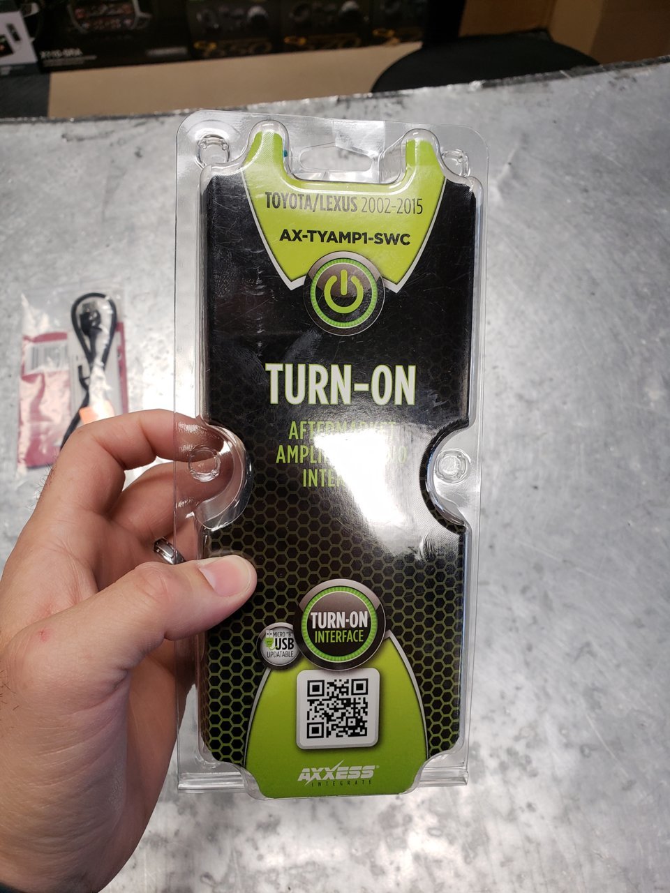

    Right.. I feel like they might have missed the amp, or maybe they missed it the first time. I used a professional shop.
    My stereo got stolen. That's why I went from 7100 to 7200. Here's the harness he used.
    First go around I had a remote shut off, and steering harness both. This shop said one harness does everything. This does the job of both. Says aftermarket amplification. Idk.

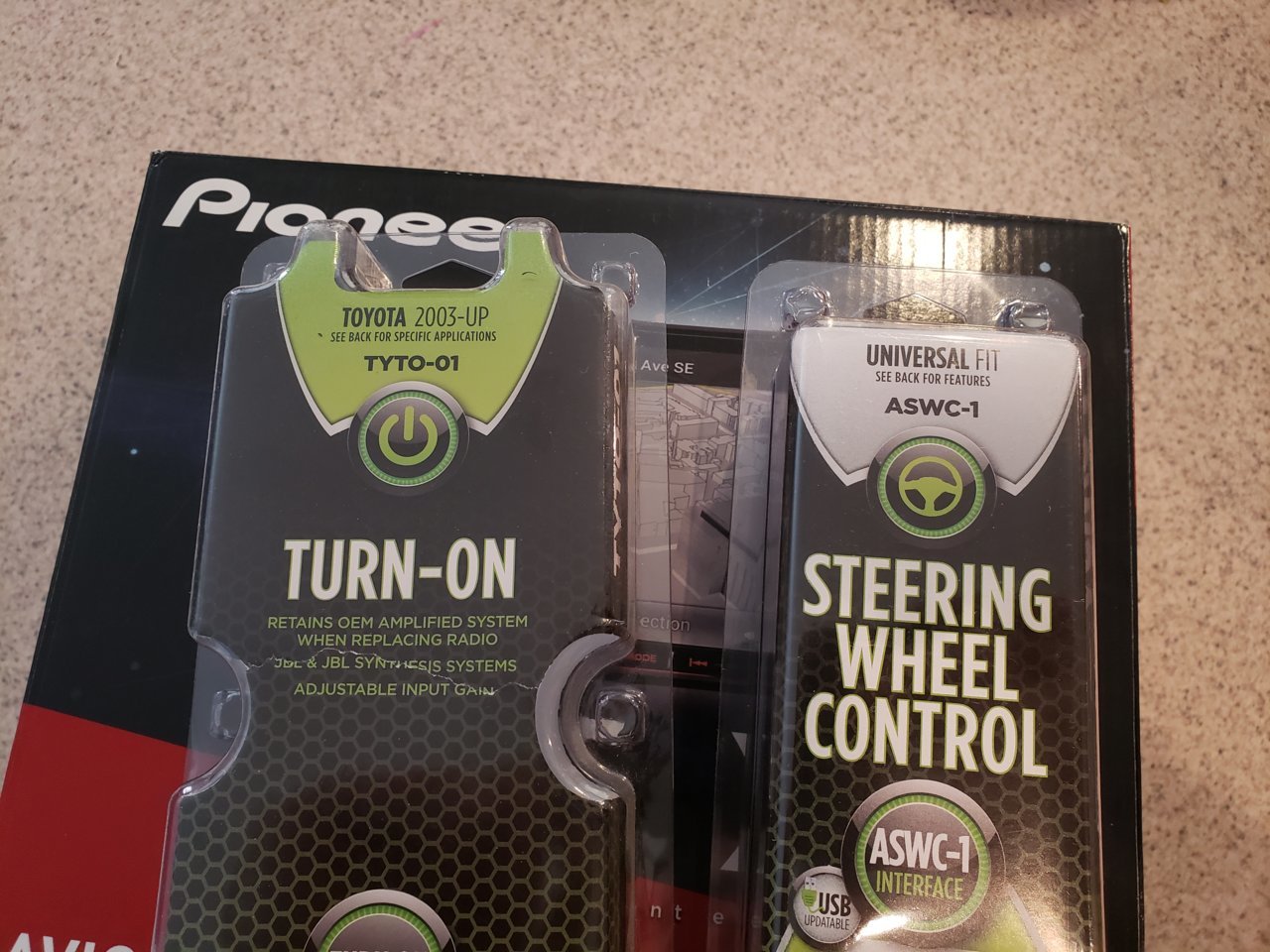

    Actually.. now after looking at info.... Maybe the first install was wrong. And this new one is right. Maybe I just need to fine-tune it.
    Here's what they used a few years ago. (Googling suggests the TYTO-01 is for older trucks) like 03-08... does anyone know?

    I would just ensure all of your speakers are outputting sound. You most likely won't have fade front/back control, so just put your ear up to each one and make sure its working. Including the subwoofer.
    With the axxess harness, I dont know if it lets you adjust settings on the factory amp like the PAC module does. We always use the PAC for the JBL system because unfortunately, the settings (bass/mid/treble/fade/balance/etc) are all actually set inside the amp, not the factory head unit.
