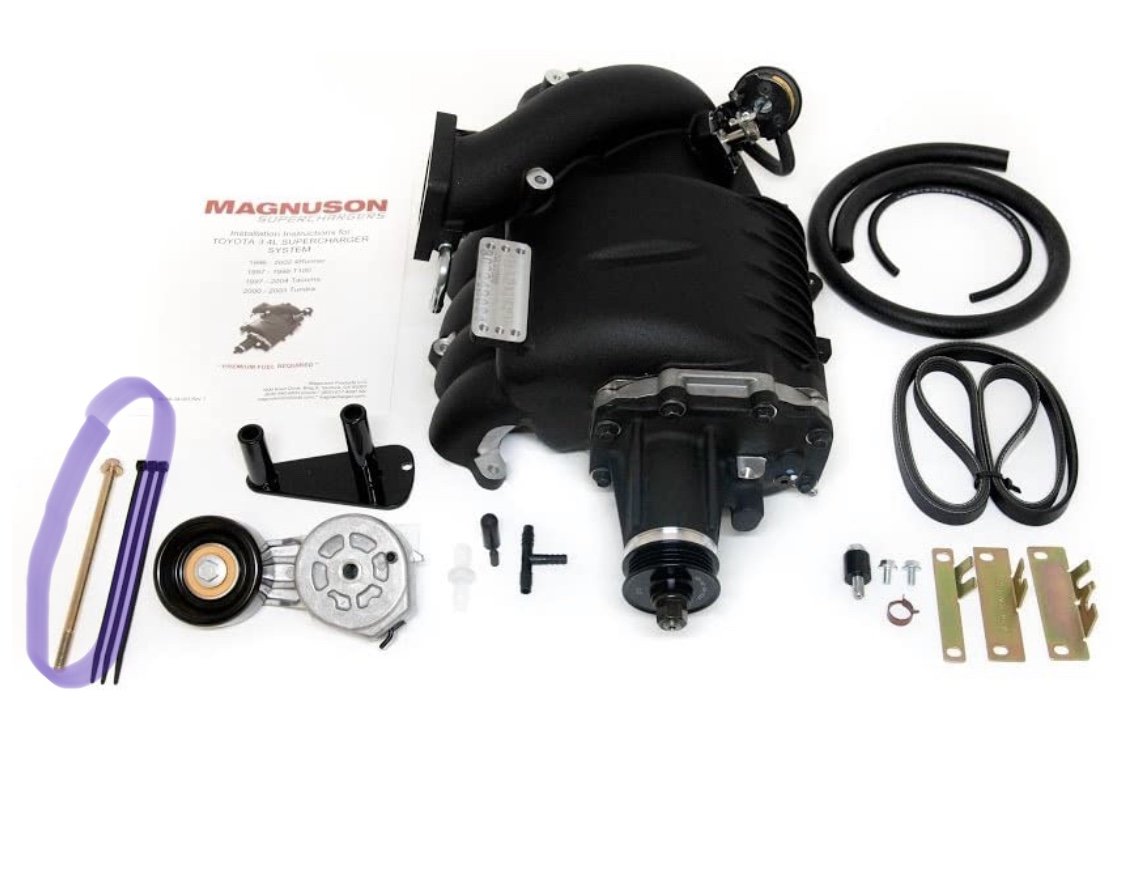

    Long shot here but does anyone know the specs or a source for this bolt? I see URD sells it in a kit but I just need the bolt. Thanks

    Measure the approximate length of the bolt. Take one of the existing bolts with you to a local supplier. It is not some one off special bolt, it is just longer with the same thread pitch. Actually, now that I think about it, the one on my supercharger, the threads are stripped and been that way for years. I need to buy another one. I plan on finding one locally.

    You talking about the long onr the goes in from the top bolting it to the manifold correct?
    I can measure mine tomorrow and post size and possible source.

    m8x1.25 170mm

    Thanks man!
