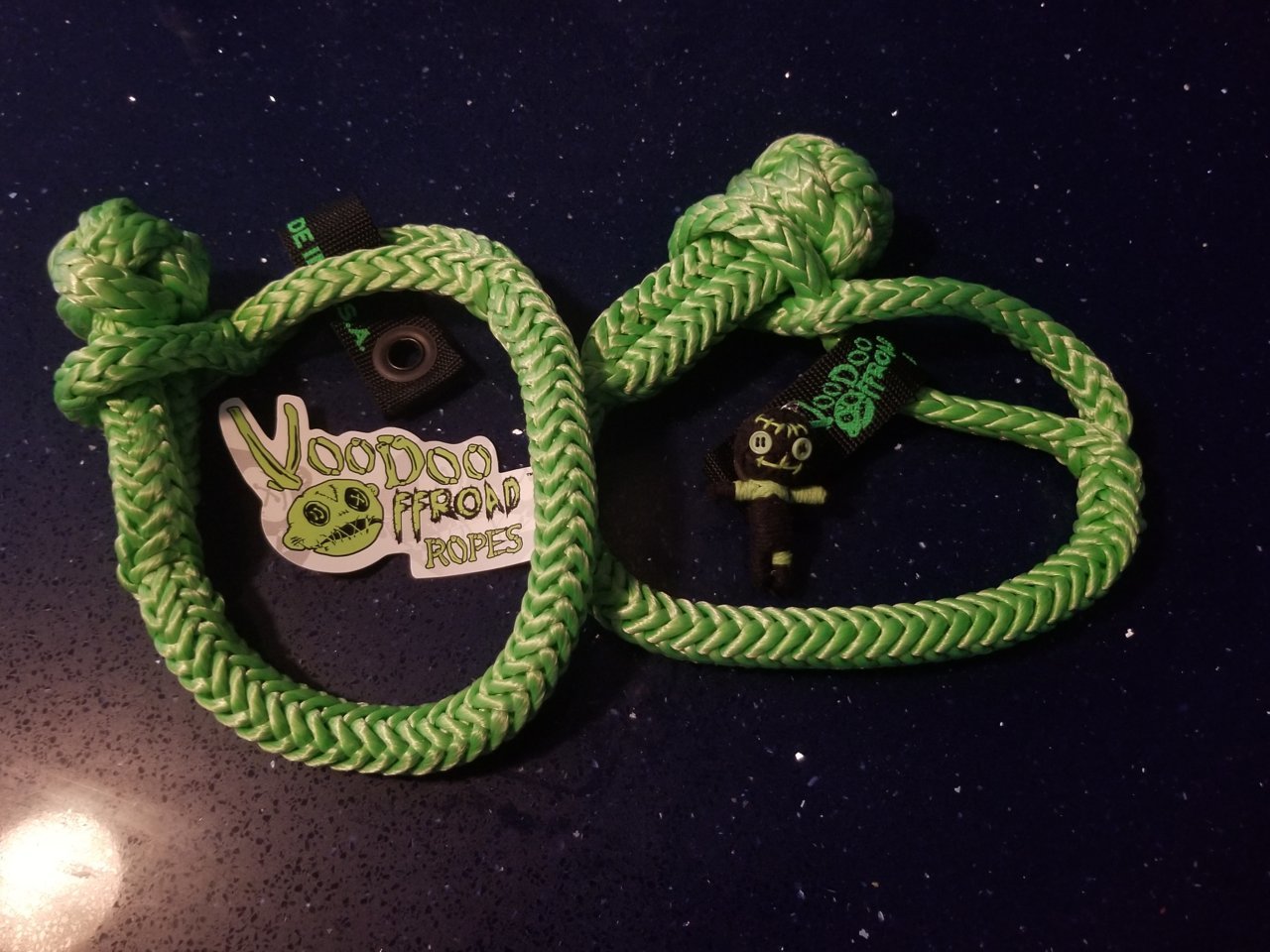

    Question for you yahoos, where do I attach the soft shackle? I have a receiver in my hitch for a 3/4 hard shackle, but what closed loop could the soft work in?

    :notsure: You can soft strap through a wheel, or soft strap two tow-lines together? Some may use them at rated towing points, but they run the risk if the points have sharp edges. WarFAb Sheridan Hitch Skid has 45 degree corners.
