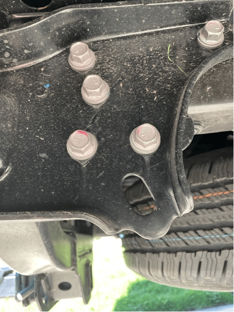

    2022 Tacoma SR Double Cab
    Can someone tell me if I can attach towing shackles to these holes on both sides of my rear frame? Thanks in advance!

    Those are tie down points. They aren't strong enough to be yanked on. In a pinch you could pull on them but I'd be very cautious.
