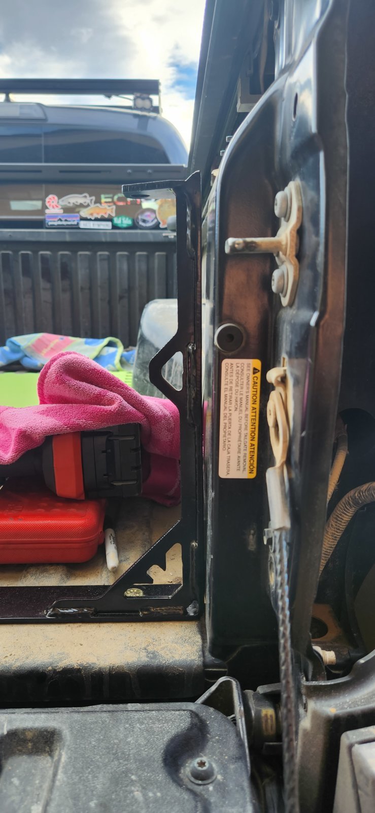

    It's to prevent the bed from spreading. As you add weight on the rails the bed will want to "stretch" out. You can see the gap I had after running a canopy for a year.

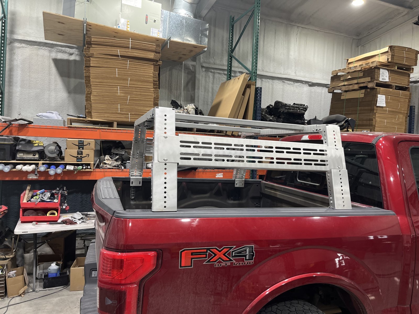

    We are working on an aluminum bed rack. Adjustable in height from 12-22”.

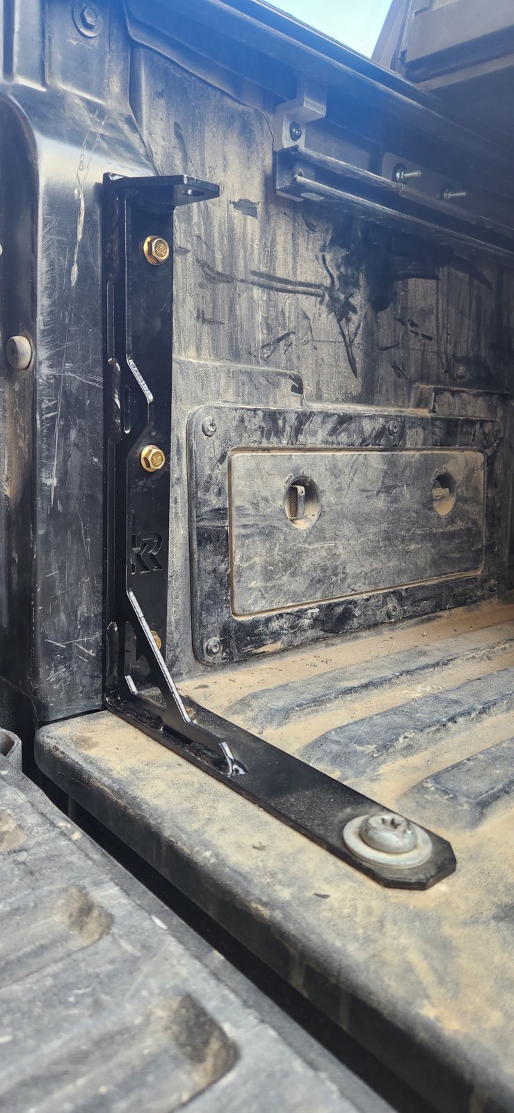

    Yes these required 3 holes to be drilled on each side.

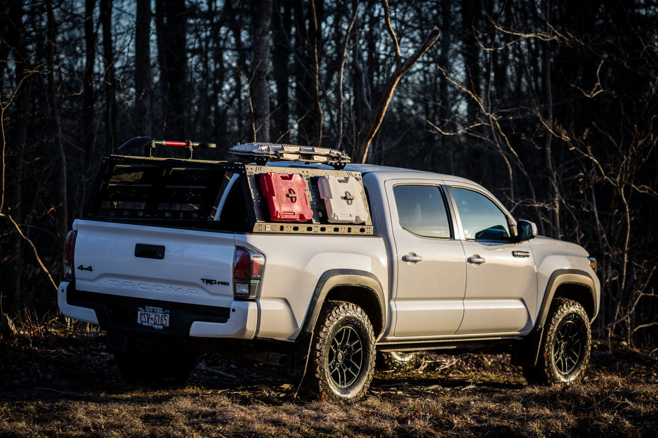

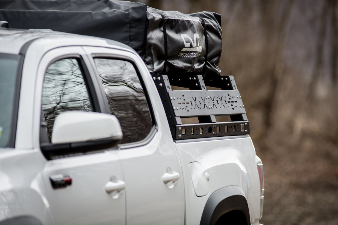

    What you really need is a rack that properly distributes the load through the full length of the bed.
    https://www.kbvoodoo.com/vrs-bed-racks
