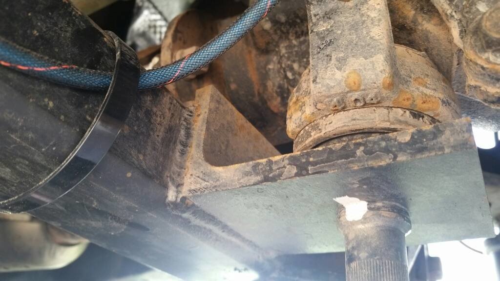

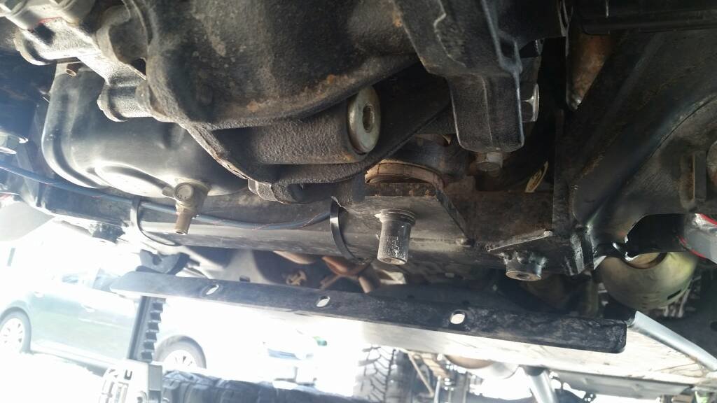

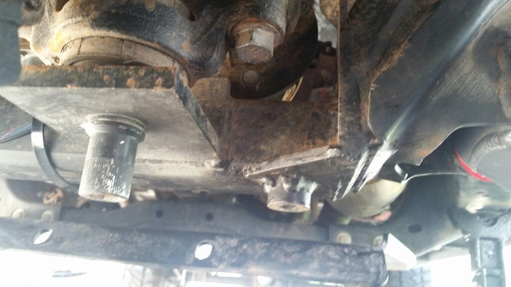

  19. Jun 14, 2015 at 2:59 PM
    #19
    AaronArf
    AaronArf Well-Known Member
    Nov 12, 2011
    #66926
    4,218
    Aaron
    VA Beach
    2023 LR OR DCSB
    So I only had the few pics from my build thread of my custom cross member, and they were hidden by the skids. I dropped all of them this weekend to do a once over from the moab trip and change gear oil.
    These pics should help you out. The triangle gussets and weld nuts were how we mounted my skids since the stock member is utilized by all oft the IFS skid fabricators. 872af66f14b23bbedc53c1e0c1911f2f_4492940e30235b8ea3b068e0f9e12b83af8ffbf5.jpg794459d21a9efa7339f58a7911dd0be6_29be7d87af829bdd60ecb719ca17e62b10c58cd0.jpg1ad7613fe83c9e2866bd4fcaad8aa030_379a32e612a3219e2b8af142ad7cafb3253e34e4.jpg5164a466fe66ff2d3175b54ee079dc82_62fc9b729dc77c86da4dc1ab175e4ab4e1a1e967.jpg

    Aaron thanks so much for the pictures! deff helps me understand what I'm getting myself into.
    how hard is it to completely remove the lift? I've really been looking at it a lot the last few days and it seems to be a lot of things to be removed.
