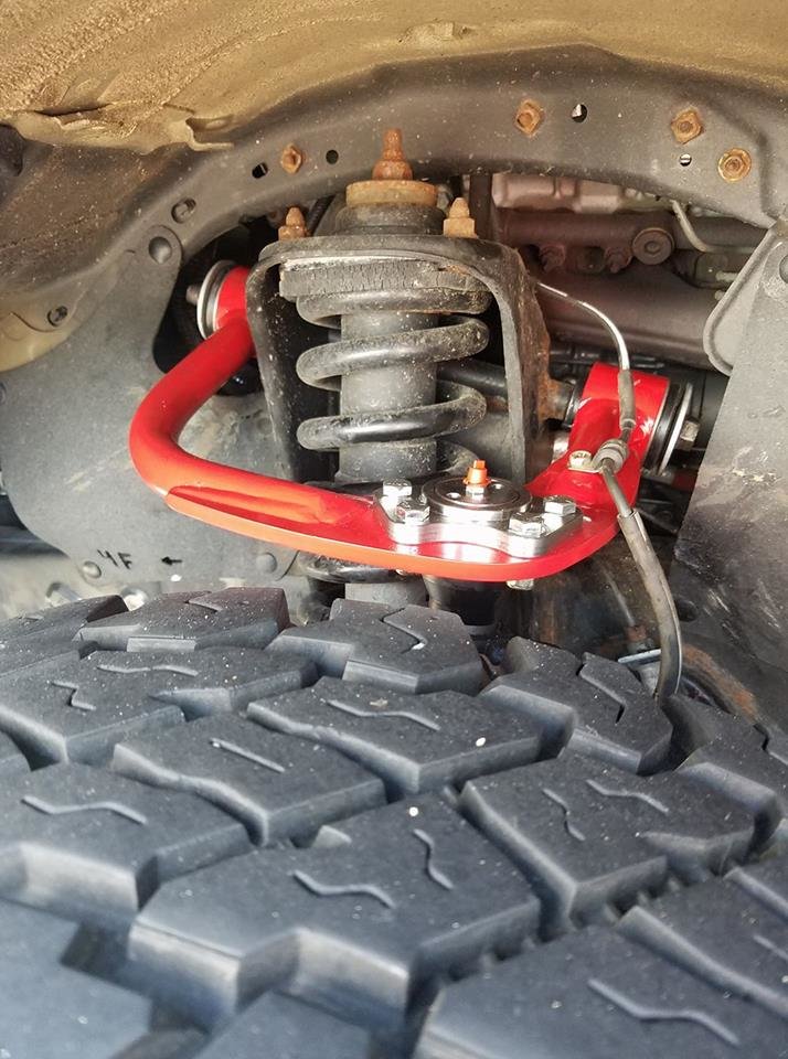

    Exactly I have OME 887's on 5100's up front and in the rear I have an ICON 3 Leaf Progressive AAL with ICON 2.0 Shocks and JBA Standard High Caster UCA's up front

    I can't wait to get my JBAs installed in a couple weeks :goingcrazy:
