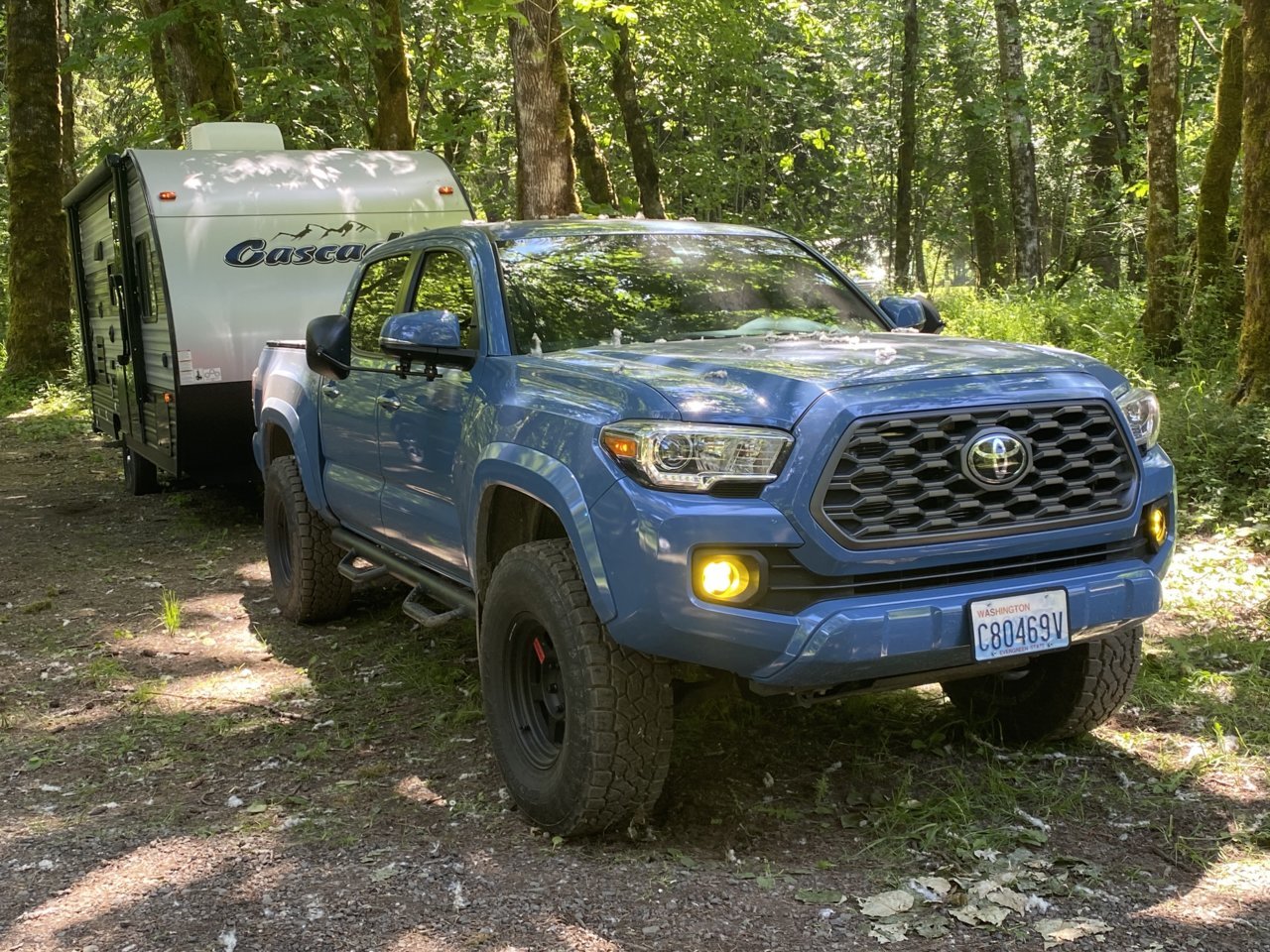

    Necessary: A brake controller is necessary - I use a Redarc Tow Pro Elite and it wired into the factory TRD harness. You will absolutely need a brake controller. Period.
    Optional: Scangauge II (or similar gear) and program it for TP1 (fluid returning from the cooler) and TP2 (fluid leaving the torque converter) so you can monitor your trans temps and pull over if they creep into the 240s - I am assuming your rig is an auto tranny. IIRC 260 is the point where the fluid breaks down and no longer lubricates the tranny so at 260 you are done and will seriously damage your rig. Monitoring transmission temps is critical in any towing situation and the 3rd gens have that cooler within the radiator that you either say "whatever" or you absolutely hate it.
    Optional: A hensley arrow will set you back a couple of grand but I would seriously consider it since you are towing something that weighs almost as much as the rig itself. The Hensley mechanically transfers the pivot point of a trailer forward to the axle of your rig. Check out their vids on YouTube, most trailer crashes occur because the trailer begins to sway at the ball, by mechanically eliminating the pivot point at the ball the Hensley eliminates the most common cause of trailer roll overs. If I wasn't using a fully articulating hitch I would have a Hensley.
    Optional: A helper spring or leaf pack. I put a Hellwig 980 helper on my rig just to fix the sag when I have my roof top tent installed and the rig loaded down for overlanding. It was hitting the rear bump stops often and felt like a caddy and the helper fixed that sag. A leaf pack will do even more but there is a cost; it may stiffen your ride (unloaded). I would see how your rig sits the first few trips out and then evaluate if you need a helper or a leaf pack.
    Optional: consider an external trans temp cooler with fans if you regularly see your temps climbing in the 230 - 240 range (as in pull your ass over and stop to let the tranny cool before you reach the critical 260 mark). I am considering a Setrab 9 series with fan pack mounted in the bed on the opposite side of the gas tank, but I'm waiting to see how my rig handles in the summer, off road (crawl speed) with 3500 lbs of trailer. There are other trans coolers that people have installed on the forum and YouTube that are budget friendly and the DIY crowd could handle.
    Technique: ECT power mode is your friend and plan to drive in S mode and ONLY use overdrive (5th or 6th) on long, flat areas or slightly downhill where there will be no need for braking. Your trans temps will soar if you are lugging the rig up long inclines in overdrive. Higher RPMs in the hills is what you should aim for.
    Technique: You will hear folks that live and die by the "only tow half of what your vehicle is rated for." I don't subscribe to that and have no issues going up to 5k GVWR on a trailer (I have a RTT and decked drawer system so I am carrying more of a load than you are in the rig). Drive within your ability and the conditions and the limit of the vehicle. You know what the rig is rated for so drive within those parameters and you'll be legal and the insurance company should indemnify you if poo happens. If you are over then you risk having a claim denied and being liable for injuries or damages caused in the event of an accident. The "tow half of what your rig is rated for" crowd are just giving general guidelines.

    Nice truck. I like your tow mirror add-on.
    Whats your average mpg with that one?
