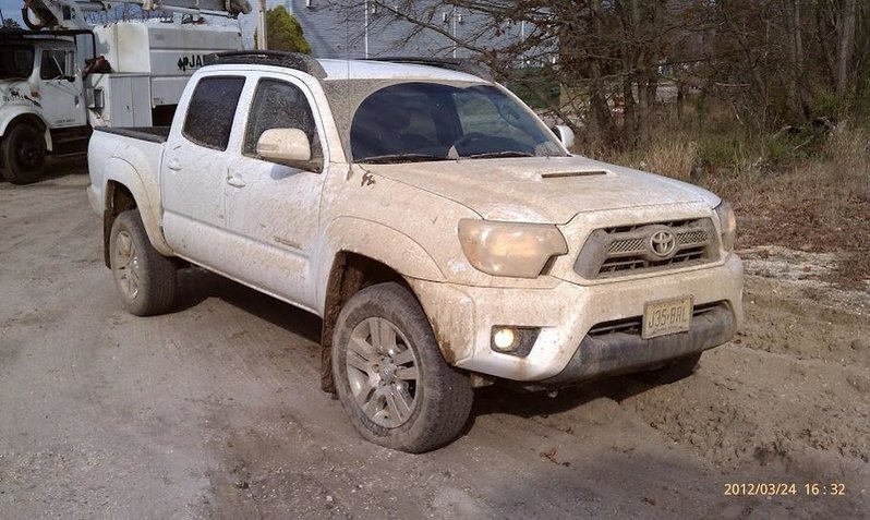

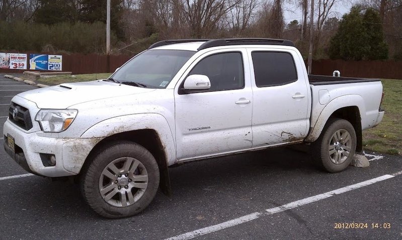

    Hi All,
    I got a SuperWhite 2012 DCSB this past December, but havent had a chance to really enjoy driving it around in the snow because there was a major lack of it on the East Coast this winter.
    I was hoping someone would be able to help me out as far as creating a wishlist of things I will need to upgrade the suspension and tires for the truck. I am looking to do a 3" lift, and put spacers in to bump out the tires 1"-1.5". Also, I've already developed a squeaky leaf but am going to try beachbumberry's leaf fix (http://www.tacomaworld.com/forum/2nd-gen-tacomas/98055-diy-squeaky-leaf-fix.html) to resolve that issue. Also would like to have the truck leveled once I have the suspension upgraded. Any input/help would be appreciated.
    Attached a couple muddy pictures I took shortly after getting the truck.
