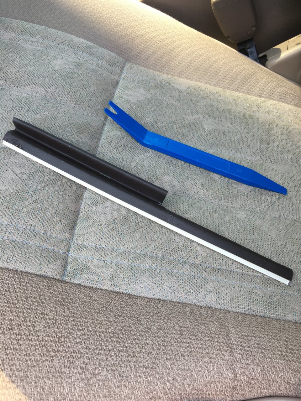

    Does anyone have information on the location of dash retaining bolts for generation 1 Tachoma. I have about 1/4 inch play in left side, creating vibration and rattle. Have not been able to find any fasteners that are loose under there.

    Thanks Ben. I followed your recommendation and forced a strip of foam weatherstripping between the windshield and dash with a plastic trim tool. Dash is now tight and doesn’t rattle.
    upload_2020-10-7_13-32-12.jpgupload_2020-10-7_13-32-12.jpg upload_2020-10-7_13-32-12.jpg

    Awesome! Glad it fixed it.
