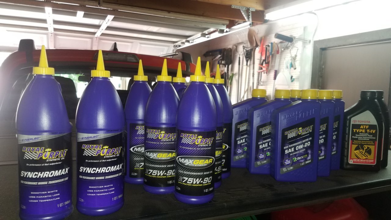

    Maintenance Journal Entry:
    Did the 30k mile service today.
    Changed the oil with RP 0W-20 and new OEM oil filter. Now that Toyota care is over I'll be following the extreme duty schedule of Q 5k miles as long as I'm towing the camper frequently.
    Changed both diff oils with RP 75w-90. Fluid looked great with minimal fragments on the magnets. I didn't need to since it was recently done post 4.88s but I wanted to get them on the regular maintenance schedule.
    Changed the transfer case oil with RP synchromax. Oil drained appeared to be in like new condition. Q 30k may be overkill.
    Inspected ATF oil. ATF looked great and appeared to be in good condition. No top off necessary. Will strongly consider a prevntative trans flush @ 60k under Toyota extreme duty recommendations.

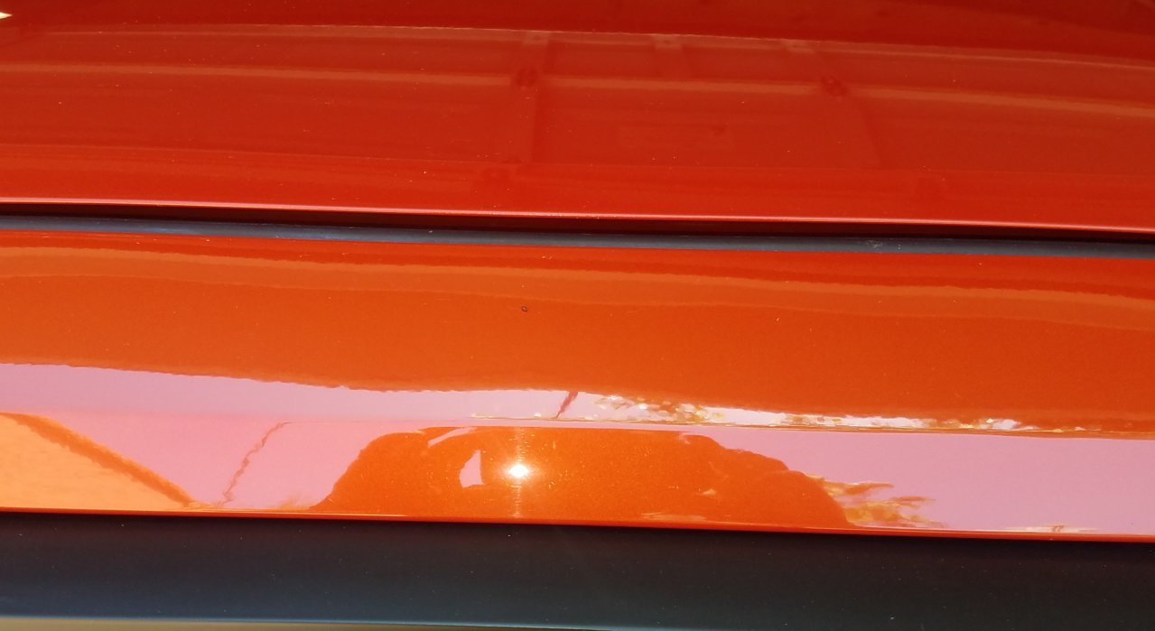

    I waxed my truck this morning and noticed I had a couple small rock chips on the hood. No big deal but realised the rock deflector was pointless so I took it off. The rock shield had pushed down the weather strip between the grill and Hood so it's no longer a perfect seal. I went over to the dealer and found out the only way to get that weather strip is to buy an entire grill assembly:eek:. Hopefully it returns to its normal shape lol.
