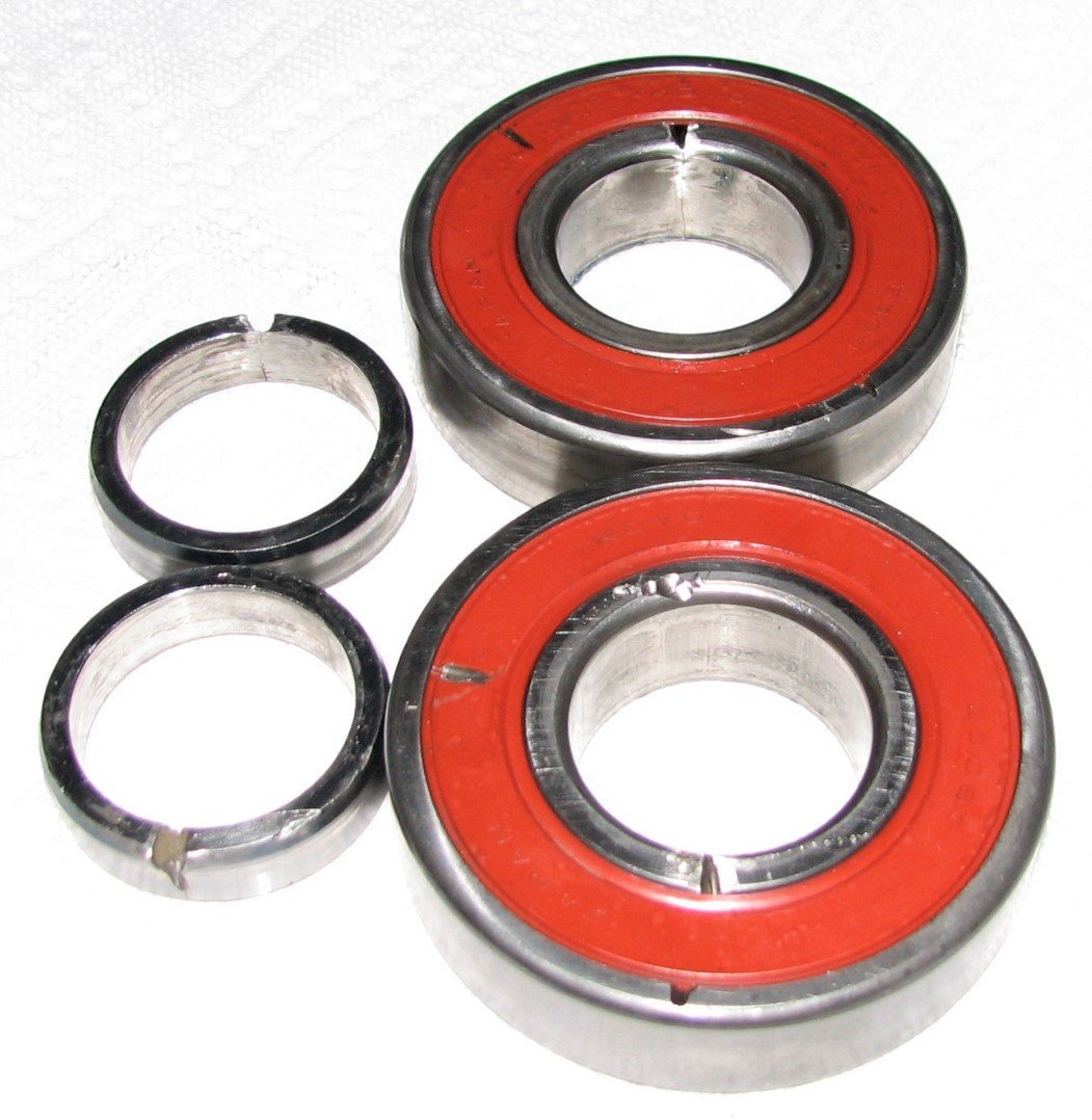

    3rz to 2Rz bebuilt block and new heads
    What about the bearings?.....those are half the parts costs...

    He said they’re going to inspect those too and if they are compromised then they’ll be replaced. But he said he’d call me back if that’s the case and he never did soooo :fingerscrossed::fingerscrossed:

    I’d just do the bearings - once they’re blown out of grease from the gear oil, they’ll wear and get excessive runout, eventually damaging your new seals and then you’ll be pulling the axles, new bearings, brakes, and seals.
    I did them minus the press work where I brought the shafts to a machine shop for $45 a side on my wife’s 300k 4runner. $250 in parts ain’t all that bad for a 300k mile wear item. A reputable shop should be able to reuse the tone rings.

    I tend to agree with that.
    You could flush and repack em, but any contamination would cause em to fail on down the line....
    New ones will have sterile factory grease.
    You'll find this job is so expensive......you wont want to revisit for a while....
