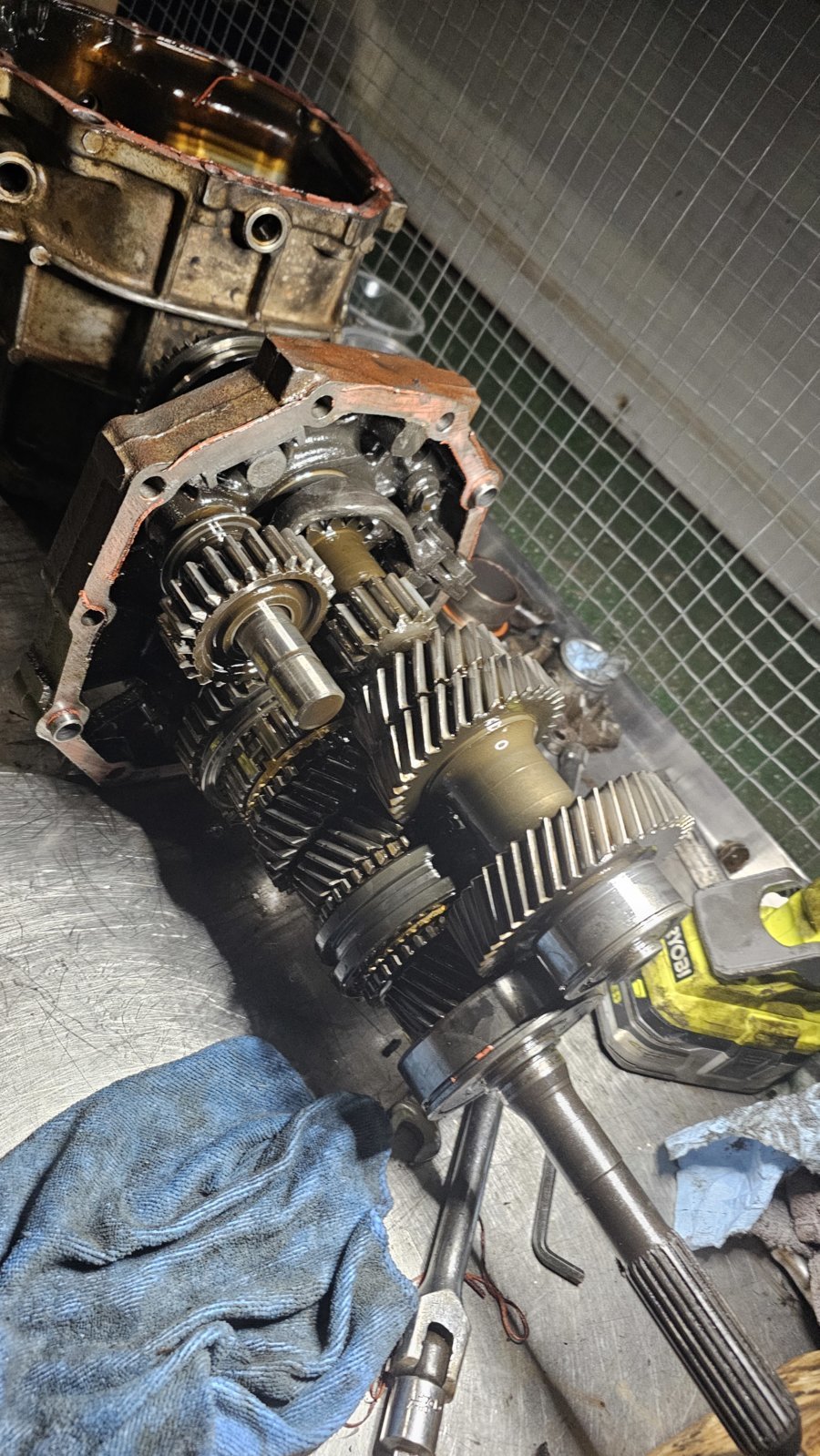

    If you are tough as hell , no need for a trans jack . They are about 60 pounds . Pretty easy to bench press .
    If you have a vise like in the picture , the transmission is fairly easy to work on . Take lots of pictures with your phone . Dont take the detents and interlocks out unless you absolutely have to .

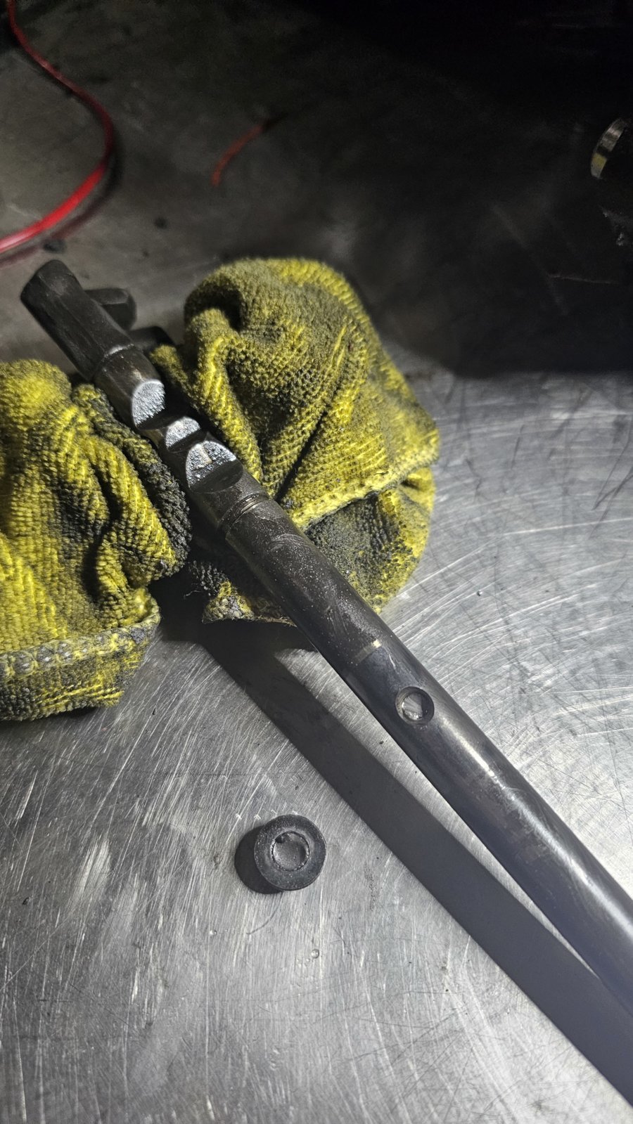

    Welp, I finally got the transmission out and found the issue. The bolt snapped on the 1st/2nd shift fork. It only took about 4-5 hours to get it out and all apart. I don't think that's to bad for my first time.

    Awesome work! Glad you got it sorted quickly without great expense. Were you able to extract the broken section?

    I haven't tried yet, I'm not sure if I can, I might price out the shift rod and see how much that is before I try.

    I would expect Toyota to get "FU" money for that shaft. But they are so random on pricing that who knows. But if you got this far I bet you can extract it. If you lack the tools a local machine shop could make quick work of it.

    There is no pressure on the bolt threads now . Left hand drill bit and a left hand easy out and the bolt should come out like butter .
    You could always weld a nut on the broken bolt and remove it that way
    Save your cash for a clutch or hydraulics becuase its still going to be hard to get into first gear when you put it back together .
    What does the synchronizer for first and second gear look like ?

    my mr2s spare transmission had a broken shift fork bolt like that. left handed drill bit got it out in a minute or 2. new bolt was a few bucks from toyota..

    Cool, ill run to the store and get those bits for this afternoon and try.
