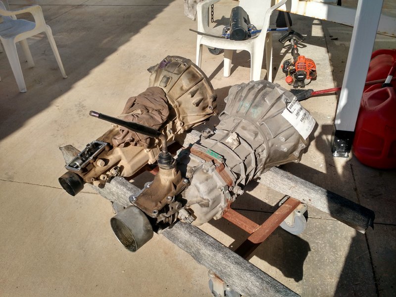

    How much weaker is the w59 than the r155?
  14. Sep 2, 2017 at 7:52 AM
    MadTaco461
    MadTaco461 BRO runner
    Dec 30, 2009
    #28470
    13,408
    CA
    99 turbo 5 lug long travel
    Kinda stock
    Decently larger. W59 left. R155 right
    gearcruncher[OP] likes this.
