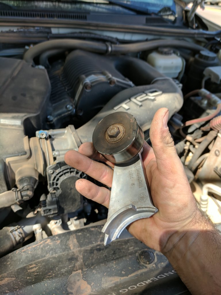

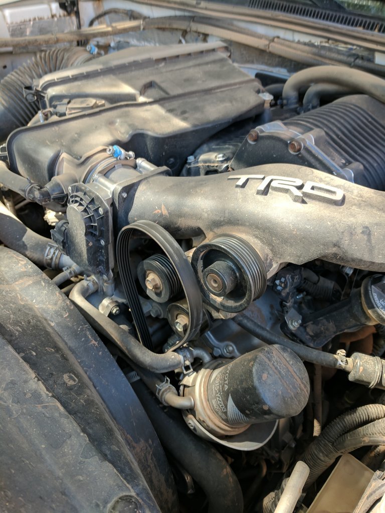

    Not even 3 months old... Snapped on my way to Discount to get a balance of all things. Truck was driving like shit.. low on power.. no codes, gauges and Torque read ok.. but didn't notice the obvious lack of boost... Belt was popped off when I pulled into discount.. I started tearing into into the get the belt off and back on.. get the skid off.. and notice this guy sitting on the lower cross member.
    12TRDTacoma and Murphinator like this.

    Headed to Toyota now to lay down a whoopin... Truck is at discount.
    They replaced the last one after they snapped it off doing a belt change...

    Appreciate it.. I'm making them cover it. I ziptied the belt out of the way and limped it to the dealer. It's getting replaced today... Then back to the drags! Lol

    Yeeeeeah. Back home now. They replaced it for me... I hate the dealer... especially this one.. but the service advisor always helps me out. I haven't had to pay for either of these tensioners. They didn't put my blower belt back on tho... Since it's a shorter non oem belt.. and they actually put the blame on that. That it was smaller and had too much tension. I said that's it's job... Oh well. I'm gonna put the Toyota belt back on for tonight just to play it safe. In the meantime.. I sent an email to this company who makes solid machined aluminum tensioners. Hoping they can make me one..

    Could somebody actually do me a favor and post up a good reference for the belt routing. I ALWAYS forget... :pout:
