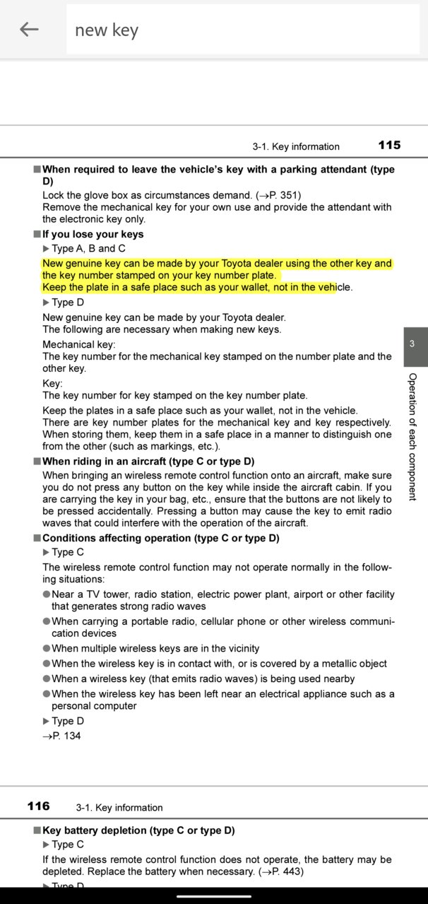

    2020 Black TRD OR DCSB
    I was given a silver plate with a 5 digit code to keep safe. They said the would help get future keys. Do you have that?
    shakerhood likes this.

    Paying 800+ for a key is criminal in my mind.
    Here's what I was referring to earlier. I took a picture of mine.
    playdixie likes this.
