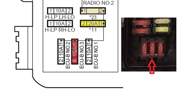

    Hello all, I'm at a loss. I just added a Gentex mirror with home link to my 2019 Tacoma. I had to change the plug, and must have grounded the 12v constant. Now my door locks key less entry hazards and dome lights don't work with out ignition on. all work fine with ignition on except the remote for locks. I have checked all fuses in both interior and engine compartment and even the 2 on body control module and all tested good. Am i missing anything would hate to have to bring it back to dealer and play dumb.. Thanks for any help

    Remove Negative terminal from battery...wait..(have a Cerveza):violent:...then replace fuse with known good one. Reinstall ground terminal to battery, verify. Report back:burp:

    Problem fixed..........Thank you so very much. Honestly that must have been only fuse i didn't check. :annoyed:

    @caribe makaira is the master of electrical on here! I gotta admit though, sometimes his knowledge is WAY above my head and understanding.

    You are very fortunate, the "fix" would've been $400.00 +....

    Dude, you're always coming through with the diagrams :cheers:
    You have the whole wiring schematic saved on your phone? haha

    You Sir seem to have all the wiring diagrams. Your knowledge is very much appreciated. Thanks.
