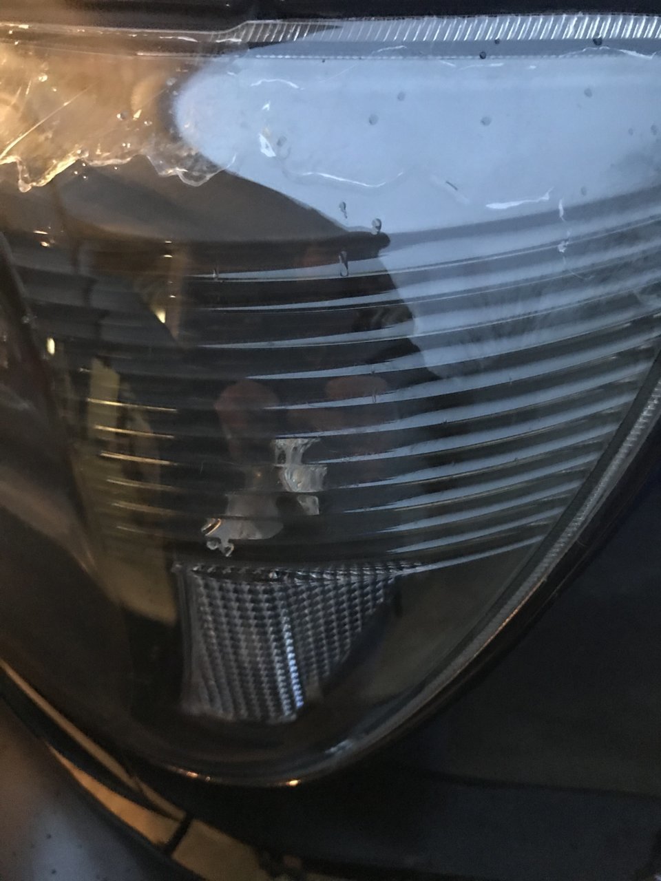

    So my led came out of the socket and fell in the headlight anybody got an idea how to get it out?

    Remove the headlight and then shake it out like a piggy bank.
    Something sticky on the end of a piece of wire...

    Yea probably gonna have to remove it which sucks lost one before lol, I tried tape on a stick one time may try it again

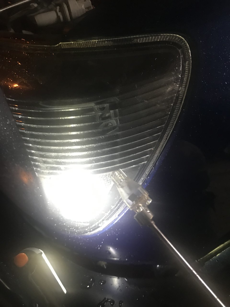

    Having been faced with a very similar issue with a backup light bulb on my son's Scion tC this past weekend, I can tell you that small magnet on the end of a flexible rod will attract the contacts on the base of the bulb. (I think mine came from my friendly, local Snap-On guy.) If you're very careful, you should be able to pull it back out that way. Good luck!

    Good ideas I’m gonna look for one of those flexible magnets at work tomorrow, last time I got sticky tape all on the inside of the headlight n it’s still kinda their lol

    SUCCESS lol first try last time I spent hours and lost it thanks for the help everyone :rolleyes:
