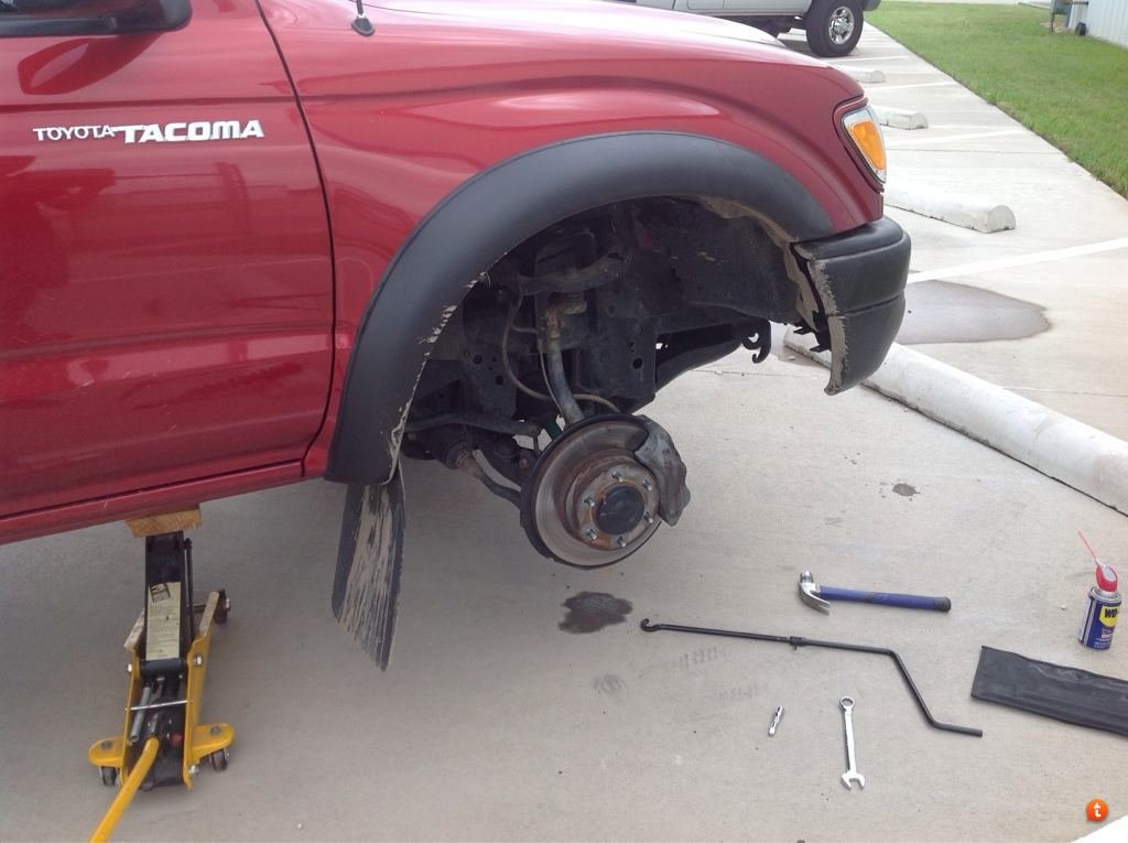

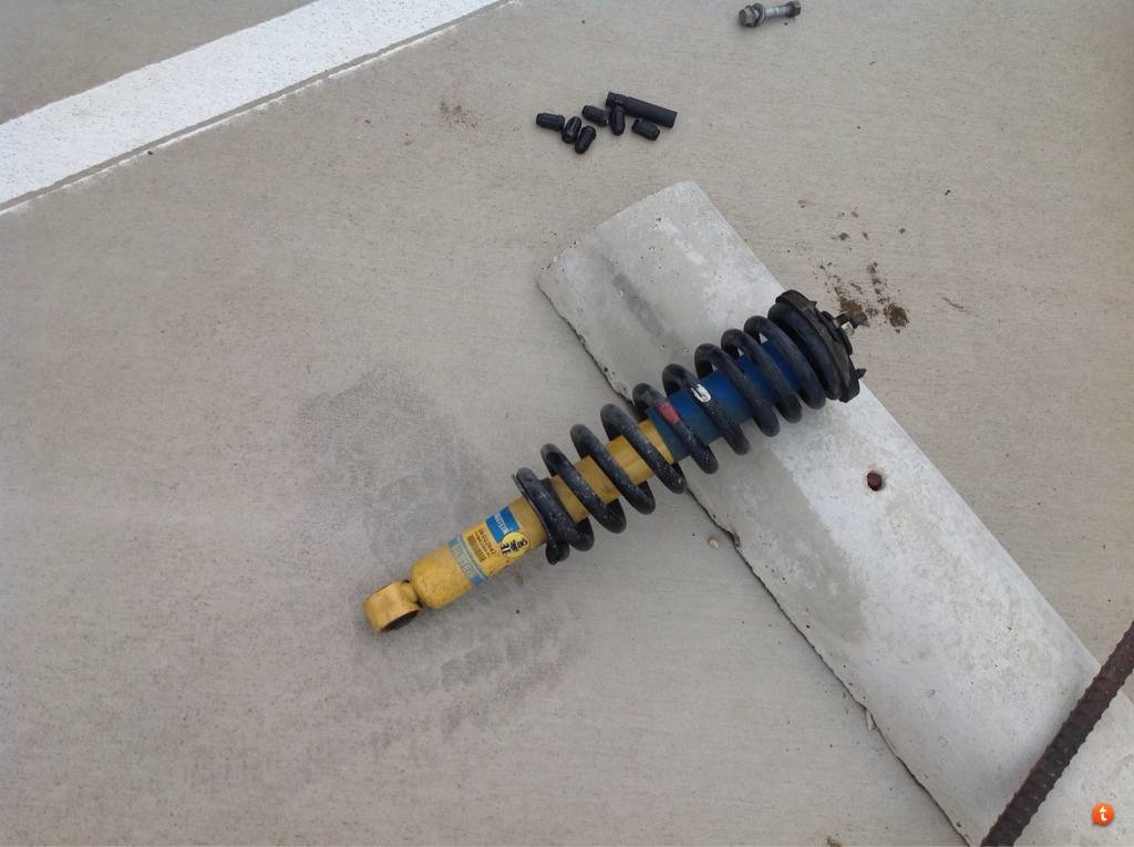

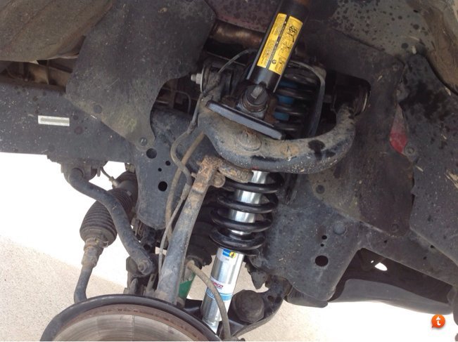

    Just installed my bilstein 5100 shocks on the front. Went to a mechanic first and he said it wkd cost 300 bucks just for the front and it was impossible for me to do it on my own. Another shop said it wouldn't work with the stock springs because they are 'too small' - all bullshit. So I rented a spring compressor from O'reillys, had a few tools and a shop jack. And went to town. We jacked up the right front end first. Took the wheel off without issue, unbolted the big bolt that holds the bottom of the strut to the LCA, undid the 3 smaller bolts up top, and the whole thing popped right out. Tricky part was figuring out how to use the spring compressor, but we managed it, mounted the old spring on the new strut, and good to go. The new strut was about a inch longer, and it didn't really want to go back in place. So I did the bottle jack trick, put a bottle jack on the UCA and push against the wheel well to force the lca down, then take a hammer and a punch hole and work on getting the bolt in place. Once it goes in, just tighten everything down and you're good to go. Took us at least three hours on the first wheel. The second wheel only took maybe 2, because we already knew how to do it. I literally only had to touch five bolts not counting the lugnuts for the wheels.

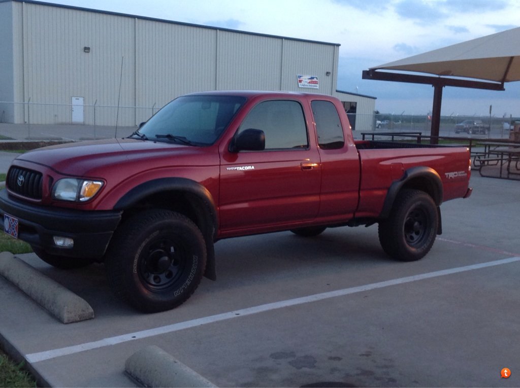

    At first I got about 1.5 inched of lift out of the front, but it looks like it settled in at an inch. It is now exactly 7" from top of tire to fender all the way around the truck.
    Also the mechanic who told me it couldn't be done without a "strut compressor" is an asshole and will be recieving a bad review on yelp.
    Pics coming

    Pics of the 5100 install! The finished product isn't a very good pic, I'll try to get another up soon.
    Note the bottle jack placement to force the LCA down.

    Yeah, they're the middle setting, which is supposed to level it, and that's what it did.

  12. Jun 13, 2014 at 9:39 PM

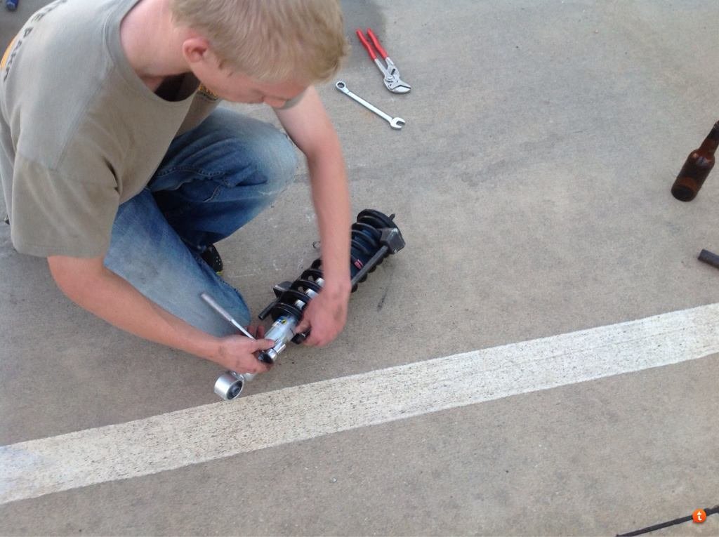

    Here's a pic of my buddy wrestling with the spring compressor. The dust boots were the least of our worries lol...

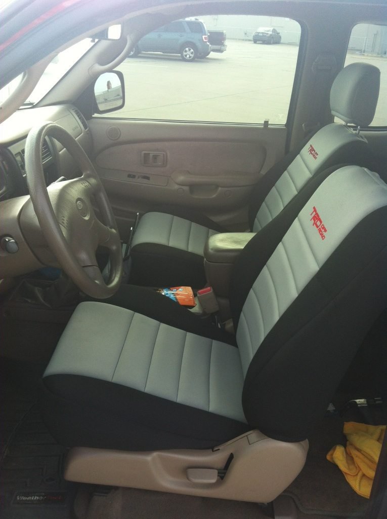

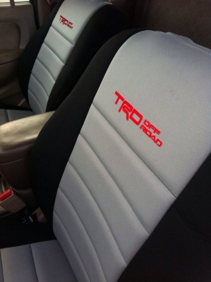

    Got my seat covers in today, bought them from ISU2014 on here. They look pretty suhhweeet, also some badass stickers to add horsepower.
