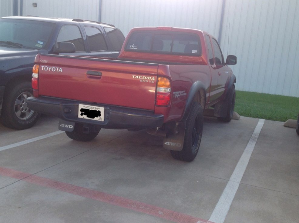

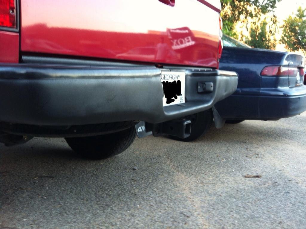

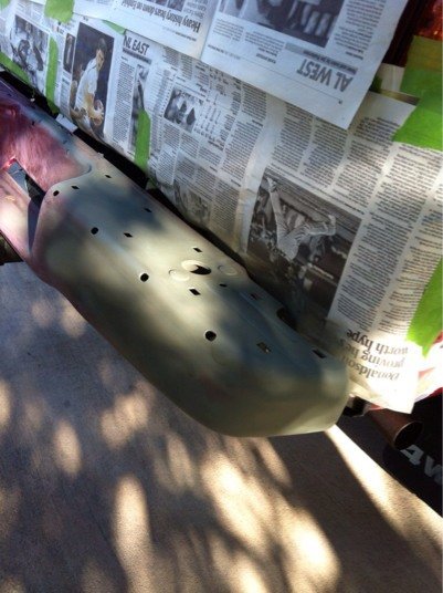

    Did my back bumper with rustoleum the other day. Turned out awesome! Gonna do my flares tomorrow. And front bumper if I have time.

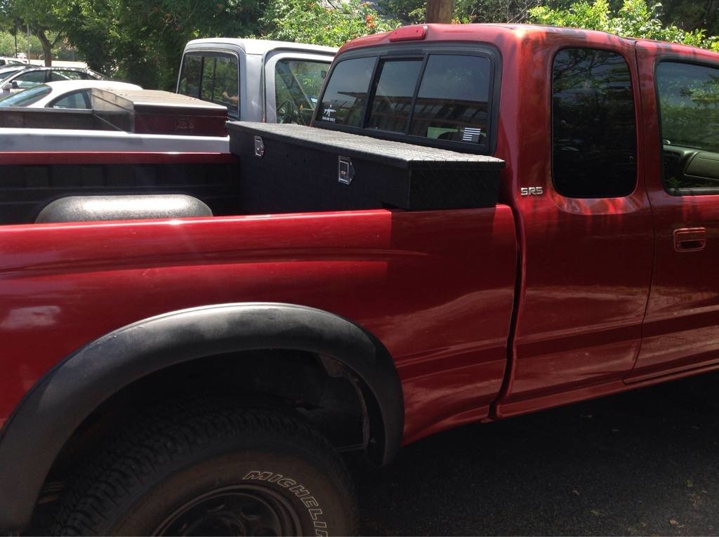

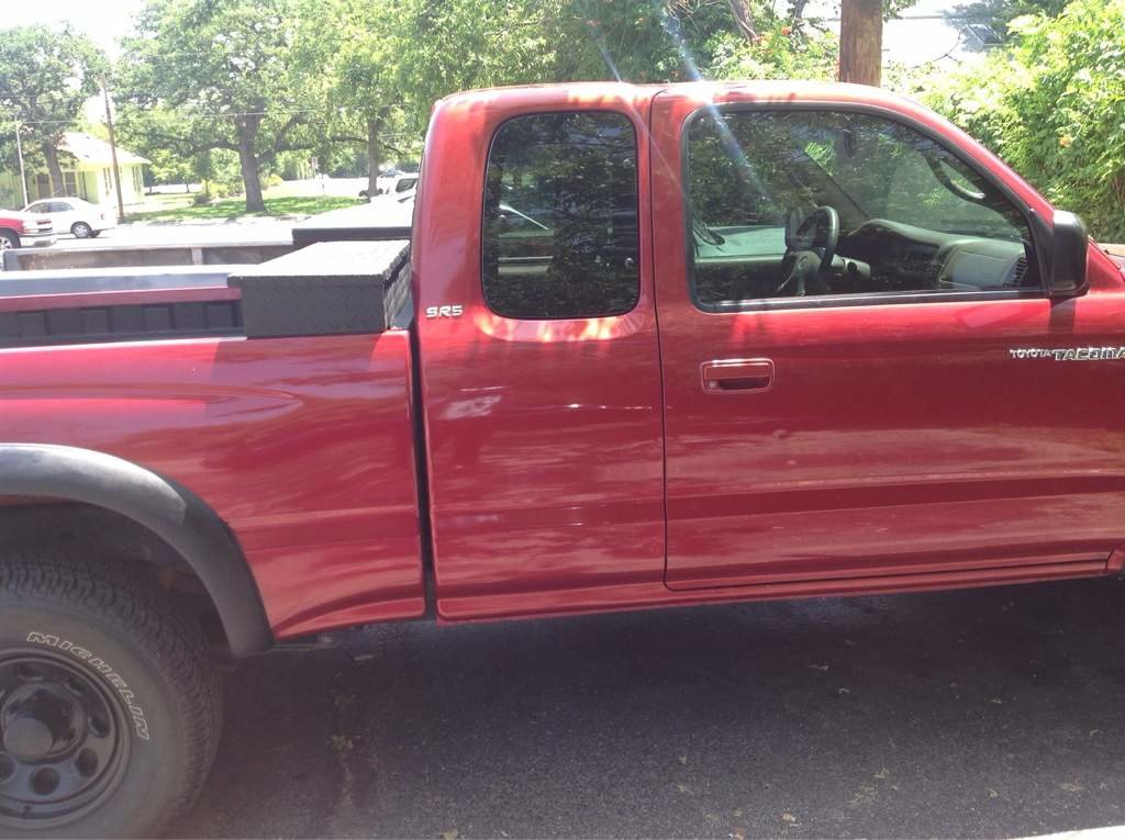

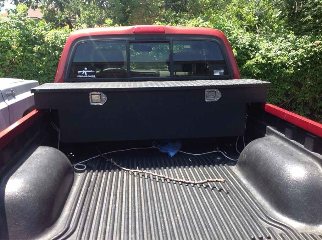

    Got me a toolbox! It's a dee zee. For 50 bucks. Found a guy who trades factory reject parts or something and it had a few dings. It started out chrome but I put some rustoleum on it and mounted it up.

    I wanna paint my rear bumper black too! The tool box looks nice and was good deal :thumbsup:

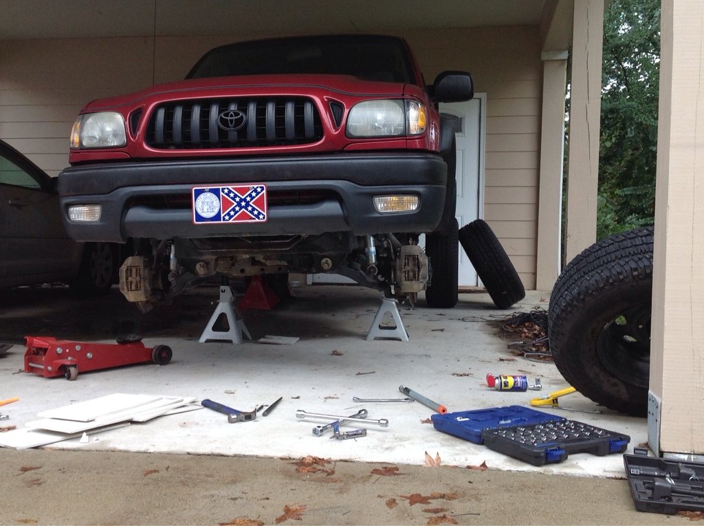

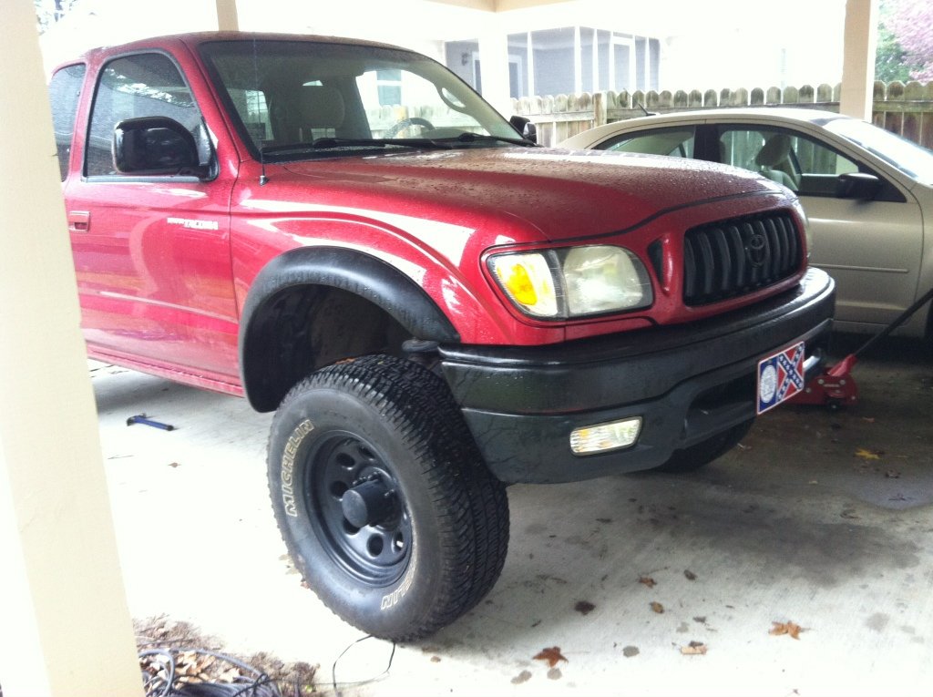

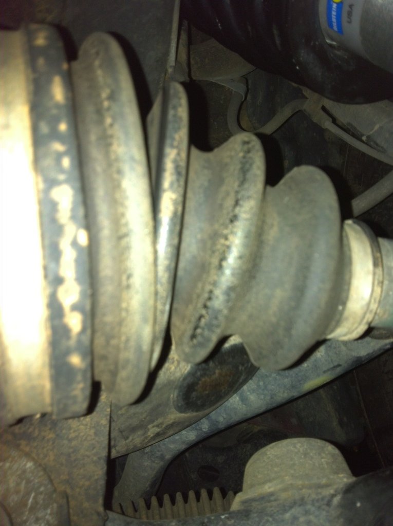

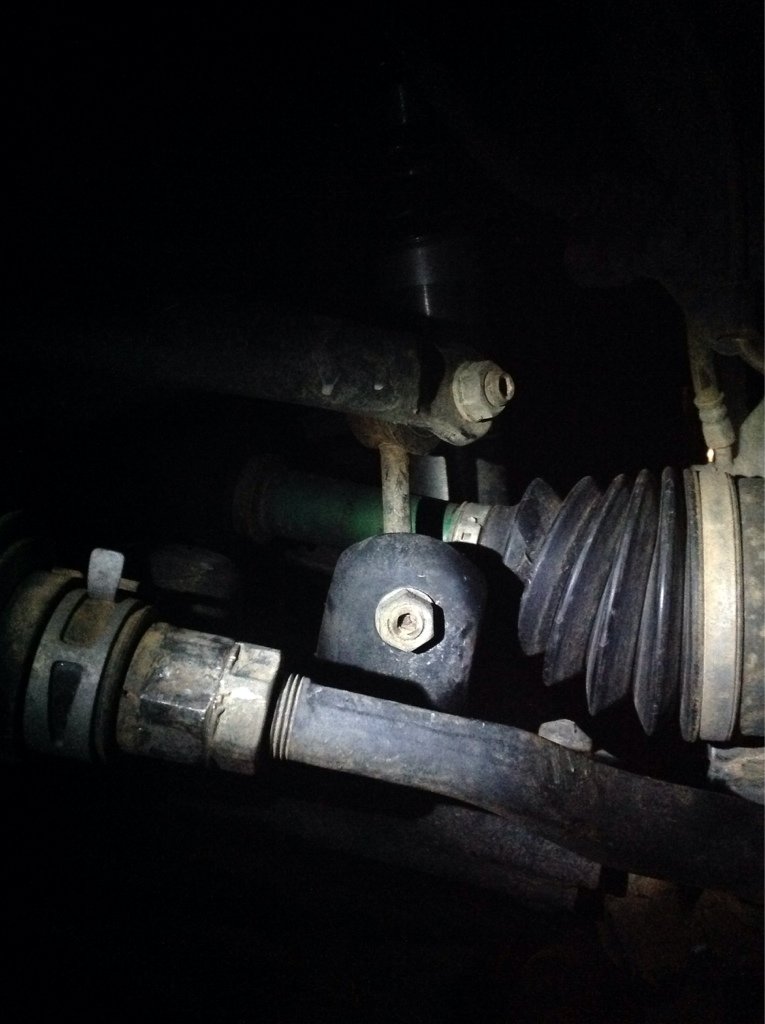

    Today I installed OME 883 front springs, and moved my bilsteins down to the stock height. It looks like I got about 2" additional lift out of the springs, so it's maybe 2.5 over stock in the front. After I got it aligned I noticed a constant "clop clop clop clop clop" sound coming out of the front end as I rode, which I assumed to be the CV joints. I installed the 1" diff drop and the noise went away. Doesn't have any unusual sounds or vibes up to 70 mph, but I didn't go any faster than that.
    I'll post a couple pics of my CV angles now, since that's what I'm most concerned about. Can anyone tell me what exactly we're looking for here? And how bad mine are/ what time of extra wear and tear to expect in the future. I'd really appreciate input.

    As for the CV angles.. What ive heard is that with lifts you can possibly see down the road is a blown CV. Where greese will just spin out of the boot. If that happens though and you decide to replace the CV you could do the CV boot slide mod.
    CV angles look a little high. As long as the fins are not touching, you should be good.
    EDIT: Found the mod http://www.tacomaworld.com/forum/1st-gen-tacomas/146070-boot-slide-mod-no-more-blowing-cv-boots.html

    Thanks for the compliment! And on the CV's is it actually going to break the joint itself or just the boot that covers it? I guess I could also go with high angle CV's and/or boots too.

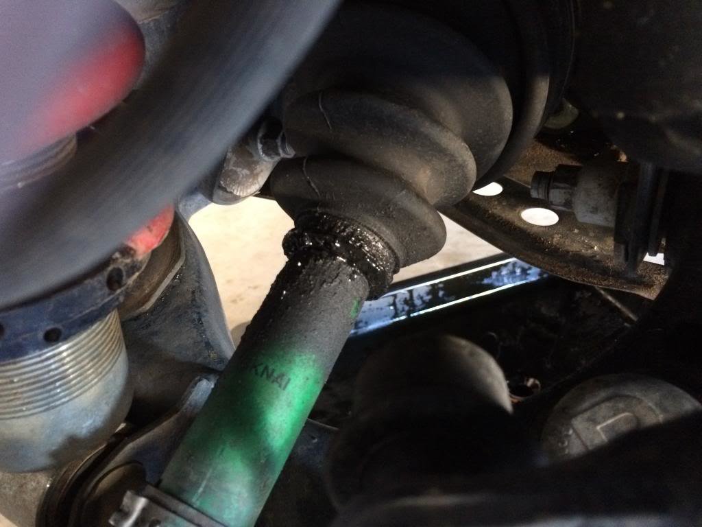

    Just the boot, would end up looking like this

    Hmm, well my inner fins are touching right now, but idk what I could do about it, so I guess for now I'll just have to wait and see.
