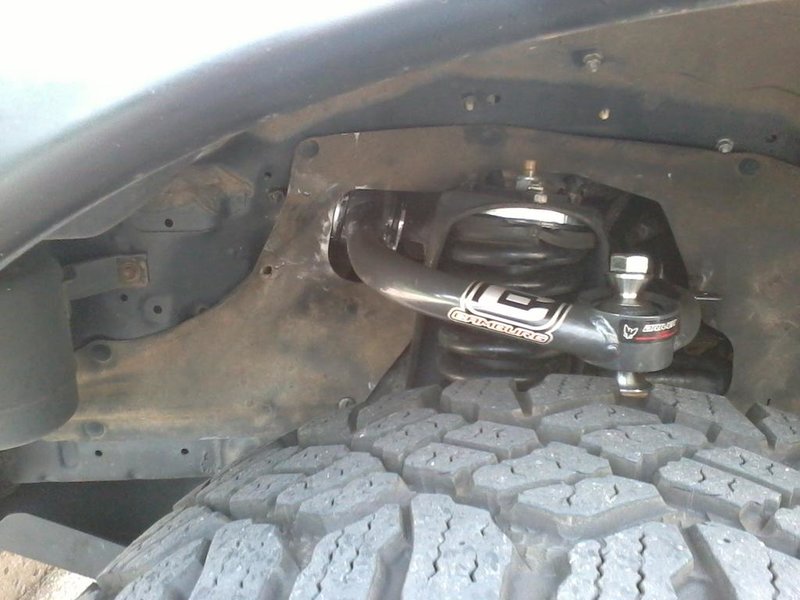

    so got my ucas on yesterday! man what a bitch... the upper ball joints gave me a rough time.... after heat and a puller it finally let loose. got the camburgs on without a problem. went to align it and found i need a new rack, again! it'll be covered under warranty but still aggravates me. but here's the finished product! never had so much caster:D
