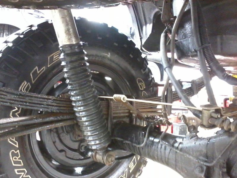

    ha nah Monte no jumps... but it is cheap insurance in my mind. 35 bux and a little welding vs a bent $300 spindle.

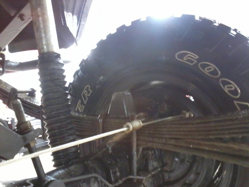

    see a problem??? lol oh well, i will get my 285s and then re evaluate my bump stop situation

    yea your ubolts are upside down :D
    definitely a good excuse to upgrade haha

    nah.... thought about it but id rather spend time and money elsewhere... i havent had a problem with the ubolts being the way they are. i want tires and a soft top first:D

    the whole point of the flip is more clearance on the bottom of the axle correct? ive only gently scratched the lower shock mounts.... plus the shock relocate is more work than i wanna do right now...

    yea...and that's the big difference between our gens is we can flip and keep the stock shock location...your process is much more involved

    yeah... im thinkin the flip willl be a "im bored" type of mod

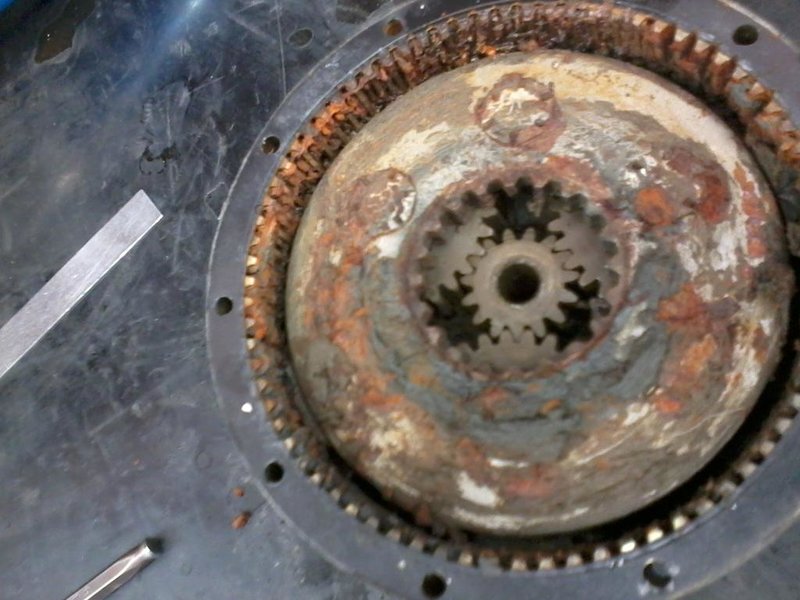

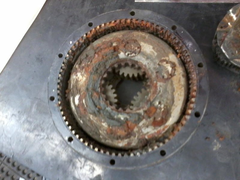

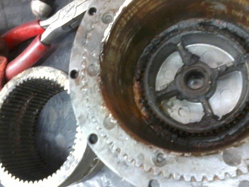

    so had a few probems with the winch the other day wheeling.... my lever wouldnt turn all the way to disengage... also it was making some not so settling noises.
    so... i pulled it all apart:D
    found extremely dirty grease. mostly moab clay thanks to kanes creek.... but there was some grease still there. i removed all the planetary units and cleaned them all and relubricated everything with new grease. wasnt nearly as hard as i figured itd be. i used a little fipg going back together so water may not get into it so easily this time.
    Wow, what a difference! the lever moves flawlessly now, and the gear noise was cut in half if not more.... very pleased with this maintenance. now im prepared for some recoveries in Moab:cool:

    I see no grease. Looks like all mud and dirt! :eek:

    it was crazy man, i could tell where i wheeled and submerged it lol. kanes creek forsure
