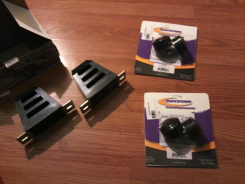

    got some soft rubber squishy things:D

    Nice stops! I need to order the same things actually.

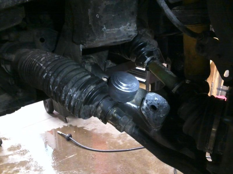

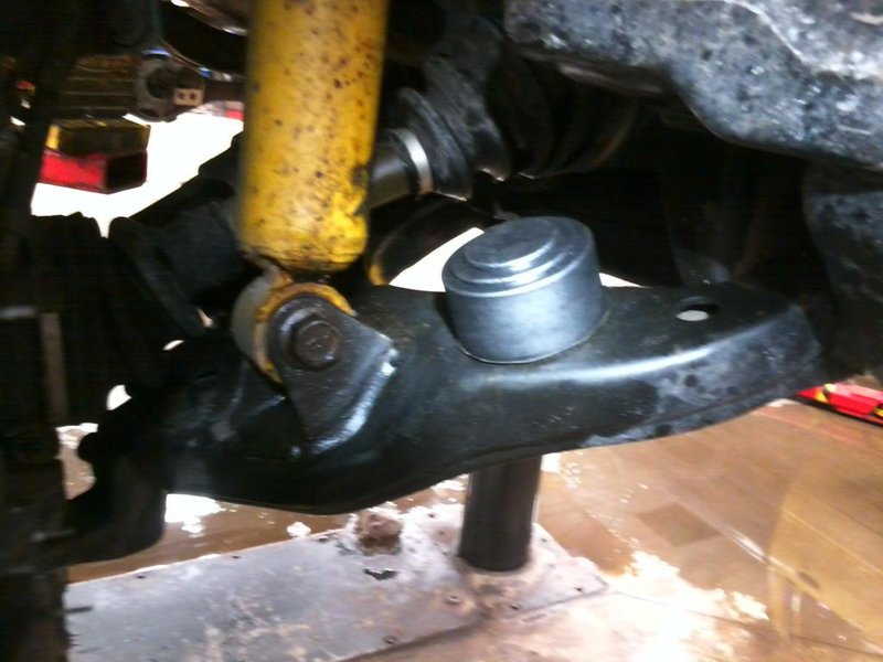

    got my front bumps in tho! had to drill out the front two. drilled a hole on the bottom of the arm and stuck my socket with the nut through the bottom. adjusted the bumps up a little taller with washers. The back ones were easy to come out. just retapped the holes for the correct thread pitch and screwed in the new bumps:D

    So just wondering...did you stack more washers on the front bumps? They are supposed to be longer than the rear bumps so they both hit the LCA at the same time. Look at your factory ones, they are different sizes.

    uup i noticed that. i have 2 washers on the front ones and 1 washer on the rear. theyhit atthe same time. assuming they hit at all. ran out of time to test them. im gonna put a dab of grease oneach one and go send her over some speed bumps. if the grease squished, they hit:D
