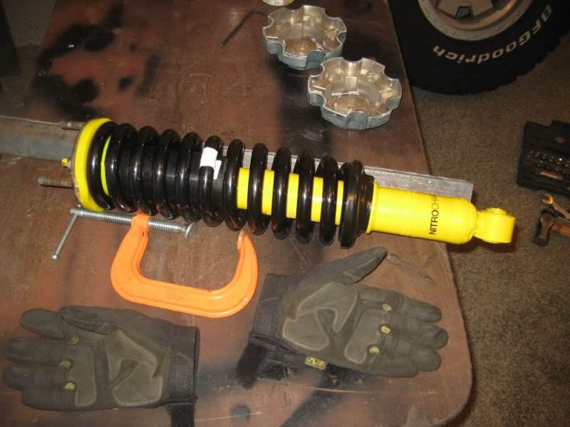

  14. Dec 15, 2011 at 12:14 PM
    #54
    lotsoftoys
    lotsoftoys [OP] pavement is boring....
    Apr 22, 2010
    #35790
    7,299
    Jace
    Denver
    98 lifted panda taco
    bunch of crap
    Thanx man, i wish more people replied too but its all good....
    yeah thats what im thinking just a top plate spacer but never understood what a trim packer is????

  16. Dec 15, 2011 at 1:33 PM
    #56
    NYCO
    NYCO go explore...
    Jul 27, 2010
    #40842
    19,126
    bOb
    Colorado
    Blue Betty - '06 TRD OR
    dents & scratches
    From what I gathered is trim packs were one sided to help with the lean caused by most the passenger and gas weight... versus the spacers that add to both sides evenly.. :confused:
  17. Dec 15, 2011 at 3:11 PM
    #57
    lotsoftoys
    Apr 22, 2010
    #35790
    7,299
    Jace
    Denver
    bunch of crap
    ok... iwas thinking trim packers were spacers indies the coil over that contact the spring directly. it just cmpresses the spring more adding lift. im thinking the top spacer like what i posted. mounted ontop of the coilover, not effecting ride quality but still adds lift...

  19. Dec 16, 2011 at 1:36 AM
    #59
    lonzorizo
    lonzorizo Well-Known Member
    Sep 5, 2010
    #42784
    1,405
    Lonnie
    Hoopa, Ca
    2003 TRD OR, 2016 TRD OR Tacoma
    I'm using a 10mm top plate spacer I got from wheelers...gave me at least half inch of lift on top of my 881's. A trim packer seats under the top plate and adds preload on the springs, affects ride but not sure how noticeably. Top plate spacer would be the better of the options if you asked me. There's a guy on here runnin an elite plate bumper and winch with 882's and a 1/4" toytec top plate spacer and he said he's at "23 1/2 " from the bottom of my fender to the center of the hub give or take." Here's his build http://www.tacomaworld.com/forum/1st-gen-builds/126312-lennys-box-rocket-copy-2.html
  20. Dec 16, 2011 at 1:43 AM
    #60
    lonzorizo
    Sep 5, 2010
    #42784
    1,405
    Lonnie
    Hoopa, Ca
    And NYCO your kind of right. 5mm trim packers are commonly used on the drivers side strut to compensate for the added weight of the battery, driver etc.
    People do use trim packers on both sides though for a little extra lift up front.
    Here's a pic from box rockets build showing what a 10mm trim packer looks like in an assembled ome setup...hope he don't mind me sharing the pic:
