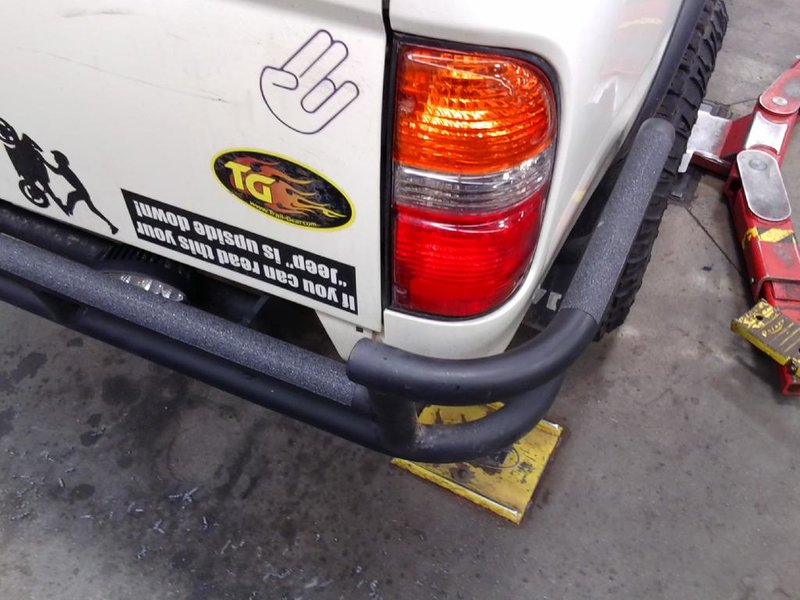

    had some time today so i redid my grip tape mod. peeled the old stuff off, repainted and new tape went on.came out nice
    oh and my aal, centering pins and spring cushings came today:)
