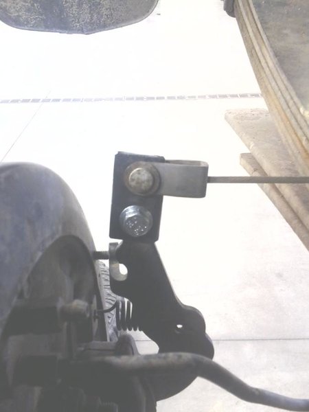

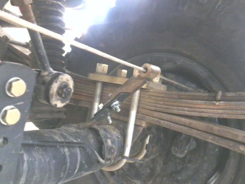

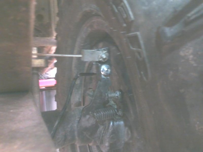

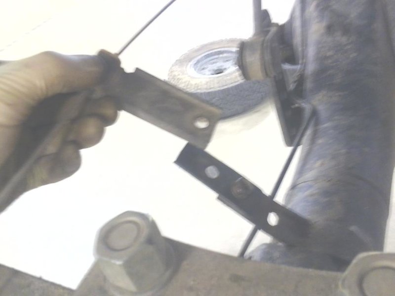

    ok well fixed the brakes! took my rear completely apart. shoes and all. sanded the shoes, turned the drums, removed bellcrank and all linkage, dropped the rear cable down about an inch near the fuel tank. made new brackets for the backing plate levers to raise the cable off the leaf pack. made a bracket for the cable guide. and cleaned and lubricated the axle pivot as well. adjusted it all and bam! i have brakes again! and now pics! hats off to the guy in that ink above. good idea, worked like a charm.

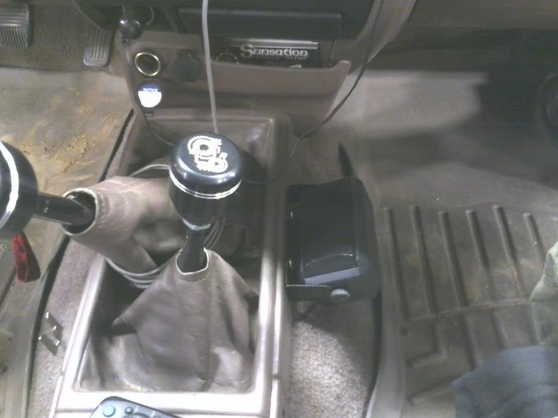

    and mounted my cb aux. speaker! may or may not have gotten the idea from Jason:spy:

    thanks man^ pita, lots of cutting and measuring and drilling. but came out pretty sweet. once u go over 3 inches of lift on the rear of these trucks, the ebrake is a b***h to work with
