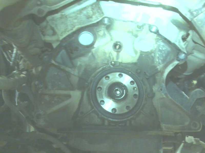

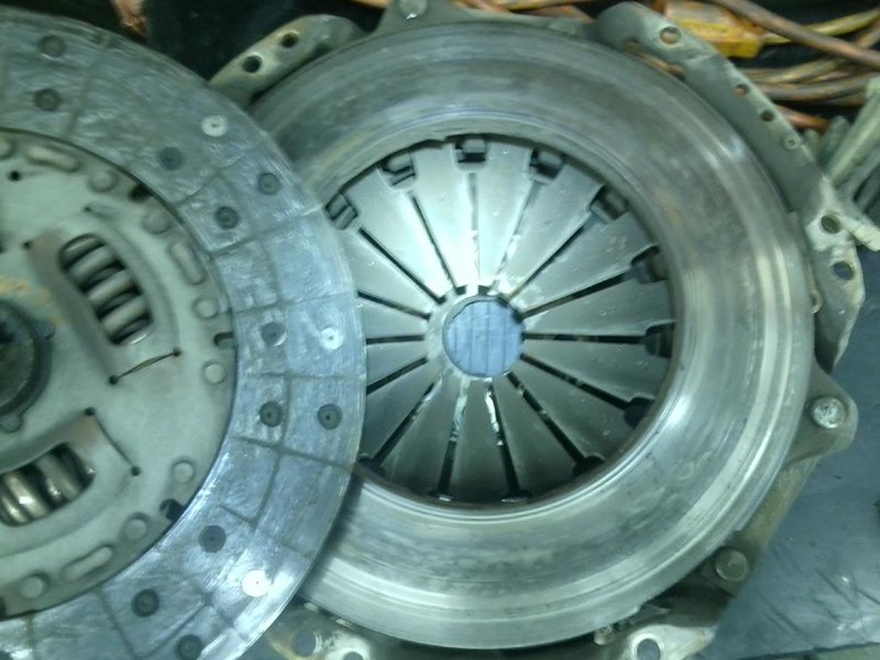

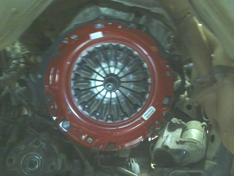

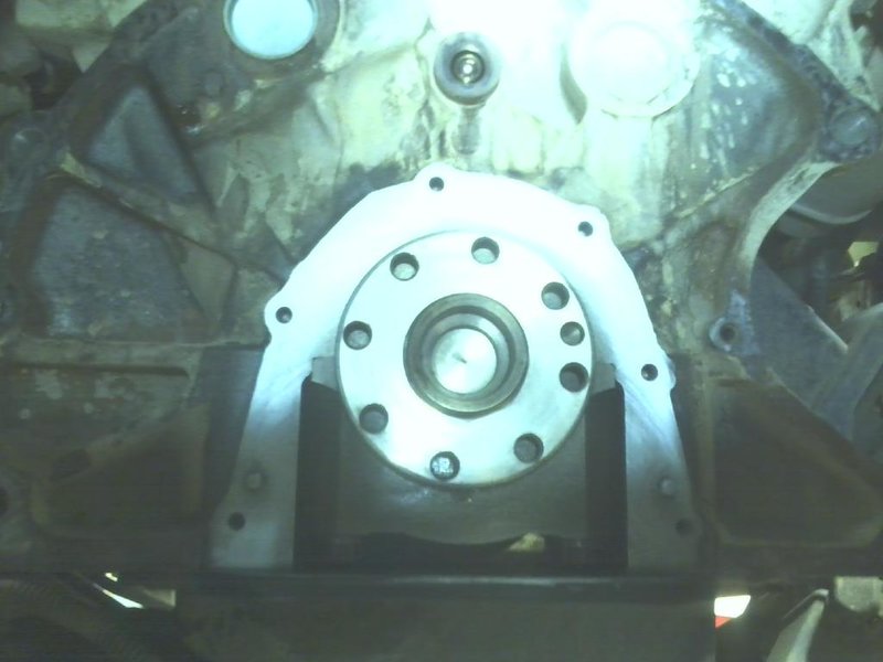

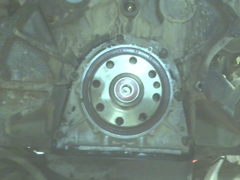

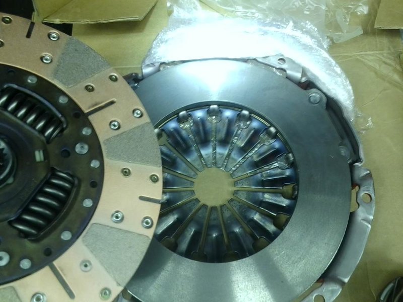

    long day....... tore the transmission out. removed the old clutch. wore it down to the rivets, it was time for a replacement:D
    found the rear main seal housing was leaking too. so removed that and resealed it, replaced rear main seal. installed the new pilot and throw out bearings. installed the 15lb heavier flywheel from LC Engineering, and the dual compound disc and pressure plate. also replaced a bad t because shifter seat.
    During the whole deal i sent out my driveshaft to Rocky Mountain Drive line to have it balanced. They are very cool and explained it was not smart to balance it the way it was. with the rear suspension the way it sits, the slip yoke had extended a good 1.5 inches further than factory at ride height.
    so they cut and retubed the rear half of the shaft with a longer shaft 1.5 inches longer. new carrier bearing and both outer ujoints and then it could be balanced.... so much better, no vibes:D
    the clutch is super smooth. the heavier flywheel is cool, really resists stalling and the rpms dont fall as fast when shifting. you can tell it is a little bit more grabby than an oem clutch for sure. only drove it 10 miles home, so in a few weeks ill have a better review. cant wait to have it on the rocks though!
