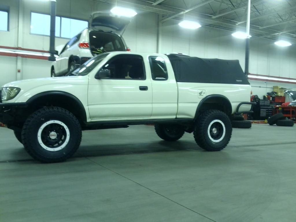

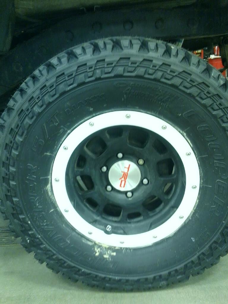

    well got my new wheels, tires, and spacers on! ive always had a thing for the tx pro wheels, greta looking factory wheel imo. i threw a little twist on mineand paintedthe rings flat white. still not completely sold on the white but its not bad. i hope it fades or i may have to respray them a different color. poor girl is showing her faded paint:(

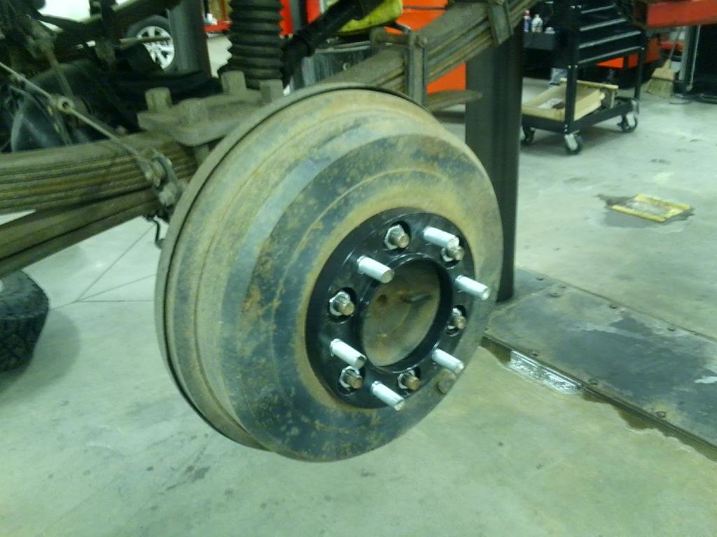

    but onto crappy phone pics! Got 3/4" Bora spacers from Marc, thanks man! they worked great, didn't stick the tires way out, only a 1/4" further than what it was. I did have to lop off 3 threads or so on the studs on the spacers. damn things are crazy long. the TRD lug nuts bottomed out before the wheel was tight. so a few minutes later running thread chasers over them, no more problems:)
    Then some photos of the new getup. I went with Cooper StMaxx 285's. Gonna give them a go. if i hate them, I know what ill go back to:D

    Looks great

    That's sharp Jace!

    thanks! i wish the white matched better but its hard to match 16 year old white.... hopefully it fades.

    Nice Jace. Been running my BORA spacers for 10 months now and they are great. Tar's look nice. I want to see them in person.

    It'll match, they just need some dirt on em. Looks great!

    yeah they seem quality other than the ridiculously long studs. the tires have an awesome look to the tread pattern. i like the side bitters too.

    curious to hear what you think of those coopers. was thinking about getting Kayla a set. not a fan on the Nitto in the winter.

    It looks really good Jace! A little bit of a :jellydance: going on.

    Wheels look good. I like the white! I thought I remember hearing you say something along the line of "POS Coopers" once though. :p

    Looks great Jace! Yea those are long studs, just cleared for me but not surprised you had to trim a scosche.

    well ill let you know my friend!
    maybe i said pos bfg

    Looking good Jace

    :woot: Cooper ST MAXX! :woot:
    I love mine in the tall & skinny size. Love your wheels too! I was considering getting those same wheels too until SCS came out with their SR8's.
