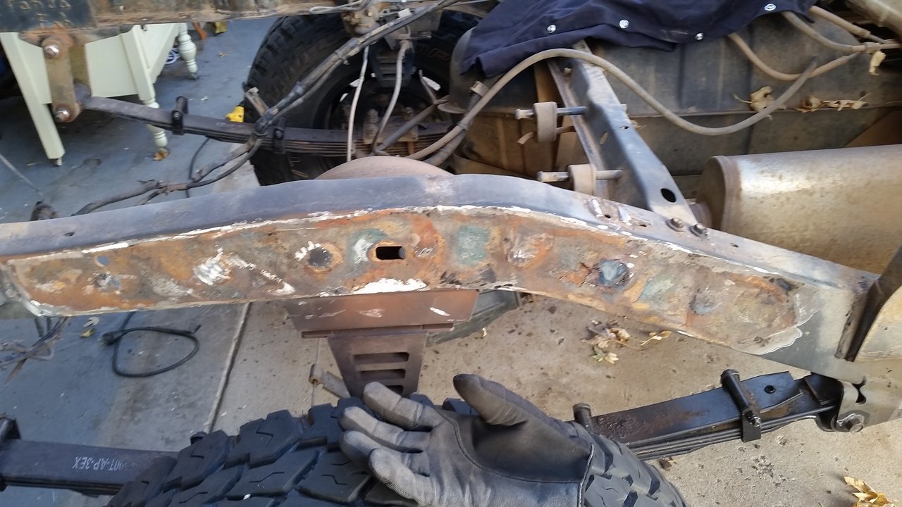

    Today I got my old frame plates off. Glad I did this... found some first Gen cancer.... it's all solid still but in one spot towards the right side. The water and dirt for wheeling sat in the factory shock mount on the inside of the frame and rusted it in that one spot. Looks like I gotta patch that up before I plate this and box it.... no project is ever straight forward smh....
