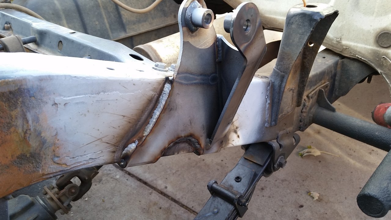

    Fuck no.... just got it patched up today and my frame gusset made for the interior after that then I need to start sealing stuff up before welding plates to it.

    Did you just stich weld the frame plates then originally?

    Yup, just like the instructions said... i'd really like to hear from TG or CBI or any of the companies that advertise their frame plates being stich welded... I can't come up with a good reason to do so. And obviously it didn't turn out so good for me

    don't they do that so you don't warp the frame from heat?

    Yeah why I fully welded the set I did.
    Sure but if you stich weld and alternate side and take your time you can still fully weld them. I did. But i also took all day..quite literally almost a full day. Turned out great

    The stiching is actually to not warp the plate... the plate wants to warp right away, frame is ok. But yes my new setup, I'm welding 360* for sure

    After I stiched welded my plates on, I ran a bead of silicone inbetween the welds to seal up the plate just like caulking up a crack. The silicone been holding up fine.

    Not worth it... not after what I found. May as well weld the whole Damn thing.

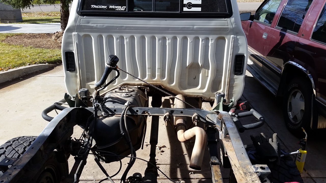

    Made a lot of progress today.... next weekend>>>frame plates
