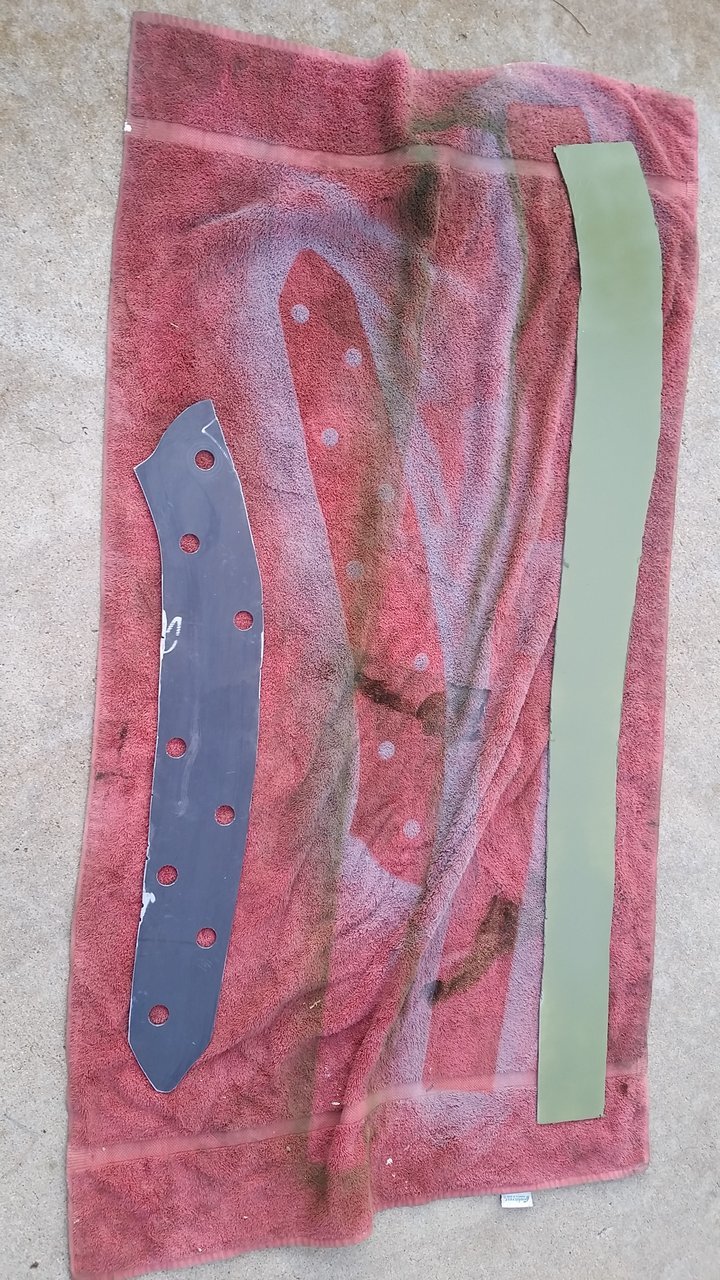

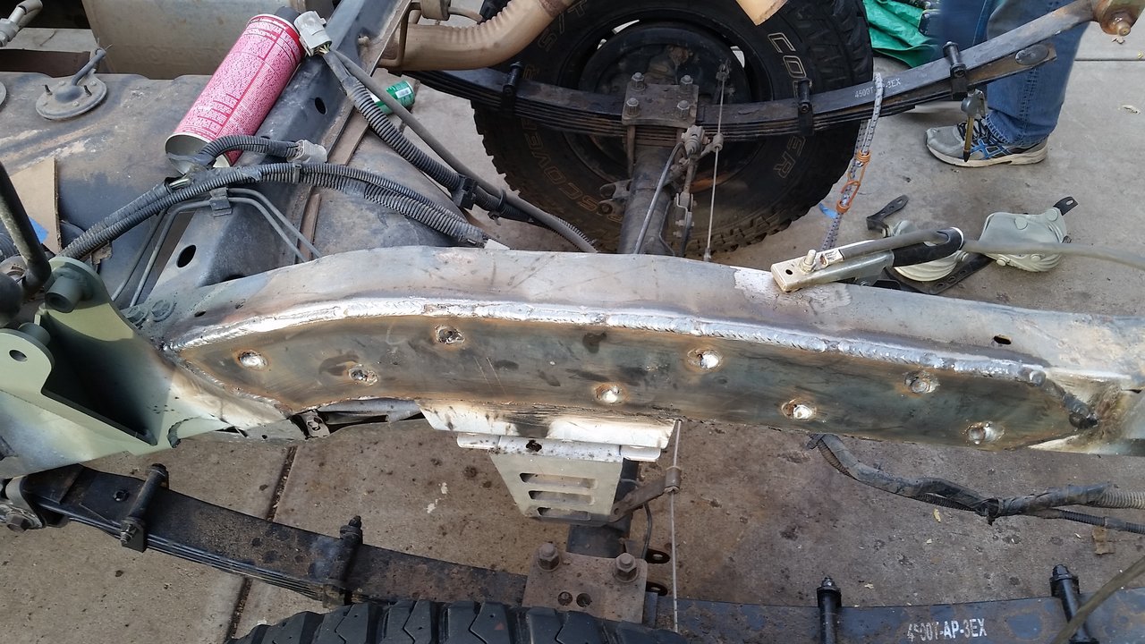

    Huge amount of progress today. My dad is a machine... worked for 9 hours today with me cutting/drilling/grinding. Plates are burned in, box in pieces are cut and fame near ready to be welded.

    Shut your plating it and boxing?wow. Nice!
    No hydro bumps for you though!

    Yup doing both, not fucking around this time

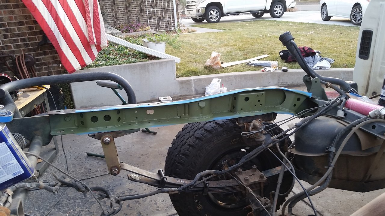

    Nice work Jace. Are you going to add a crossmemeber in the middle of the frame? Just in case you have to pull the bumper off the frame will stay square and you won't have to fight the frame to put the bumper back.

    Yup making an x brace out of 1.75" DOM once the inside plates are in.
