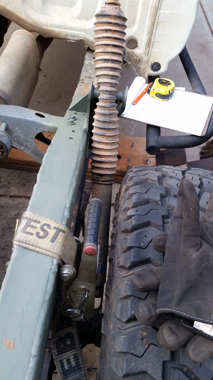

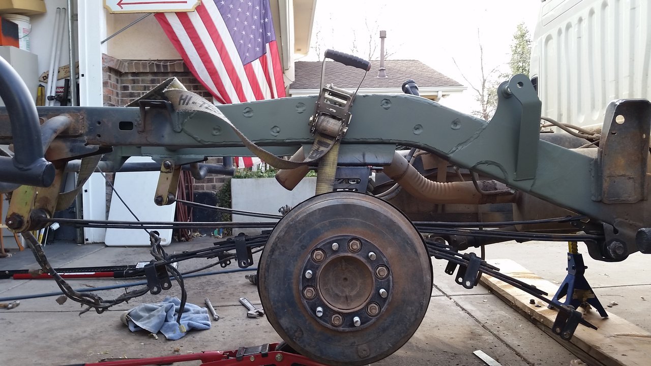

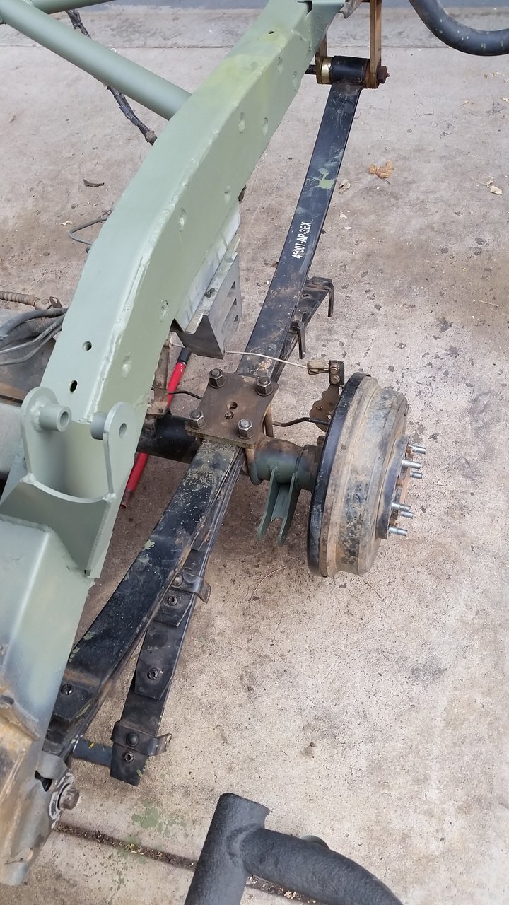

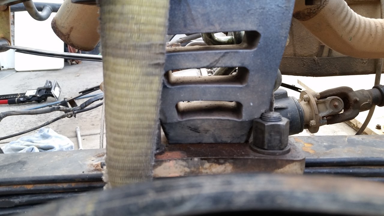

    OK so I know I need to move my bumps down about half inch. That will make them contact the leaf just as the spring reaches flat-hair past. Because I'm gonna move it down it took some travel away. My travel numbers were measured from bottom of frame rail to the top of the built flip plate. 10 3/4". Minus the half inch from me moving the bumps down. So 10.25.
    @Squeaky Penguin u guessed right on travel;)
    Because my shocks are mountRd at the new angle tho my shocks will need to be longer.
    My compressed measurement is 21"
    My extended measurement is 30". The problemost I'm seeing on my quick search of kings is the 10 inch stroke shocks only extended to 27".
    Where as the 12" stroke shocks have specs of: 19.5 compressed and 31.5 extended...
    The tires is gonna get super close when flexed. Hope the 1.25 spacers help with that. I'm so excited to feel a rear suspension that doesn't bottom out on the shocks!

    How much do those bumps compress too?

    I welded them on. After seeing the available sizes of shocks. I was well out of the 10 inch shock range, so there is no point of moving the lower mounts. And those bumps compressed about an inch when I cranked on it really hard. Again they are moving down.
