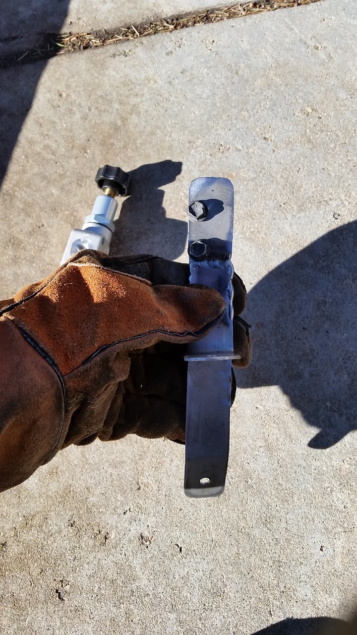

    I'm just worried I don't have a good spot for the resi. Also with the top of the shock forward of the axle a bit, I think the attached resi will clear. And there's no hose to leak...

    X2 resi with hose.

    Do what Brett did with the resi. Attach them to your X inside of the frame. You can get fittings and long enough hose to reach.

    I was just going to say, get a couple 90s and mount the resi on the inside of the frame.

    More spots to leak though... I need to bolt the new spacers up and wheels and flex it again and see what my best options are

    Run a longer hose to put the resi at the back of the wheel well. I can do it for you or measure out how far back you want/need it to be and let DSM know to make it that way. Don't worry about the resi hose leaking. if assembled correctly they will be just fine.

    Well right on, that makes me feel better coming from you man! Like I said I'll toss the tire on again and see about where the resi would fit

    I make custom hoses for Fox 2.0's all the time. T4R are about 26" long and 2nd gen Taco are 20ish. They operate just fine and have no issues. See if DSM will put the 2.5 Comp adjuster resi on the 2.0 smooth body shock. If valved right could work awesome for a 2.0.

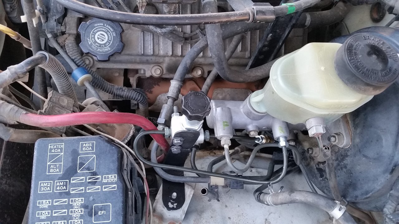

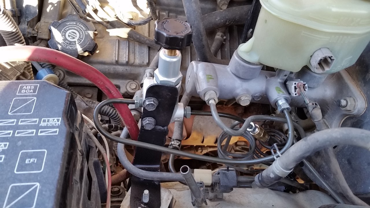

    She's almost done! Removed the charcoal canister and made a bracket to hold the new Willwood proportioning valve. Then I got busy making lines. Came out freaking sweet. Threw the lspv in the trash;)

    Looks great, I do see a couple evap codes in this picture if you didn't catch that.

    Man, can't get nothing past u eh!? Lol yeah I found that before I buttoned it up the first day and thanks for the help with the bed!

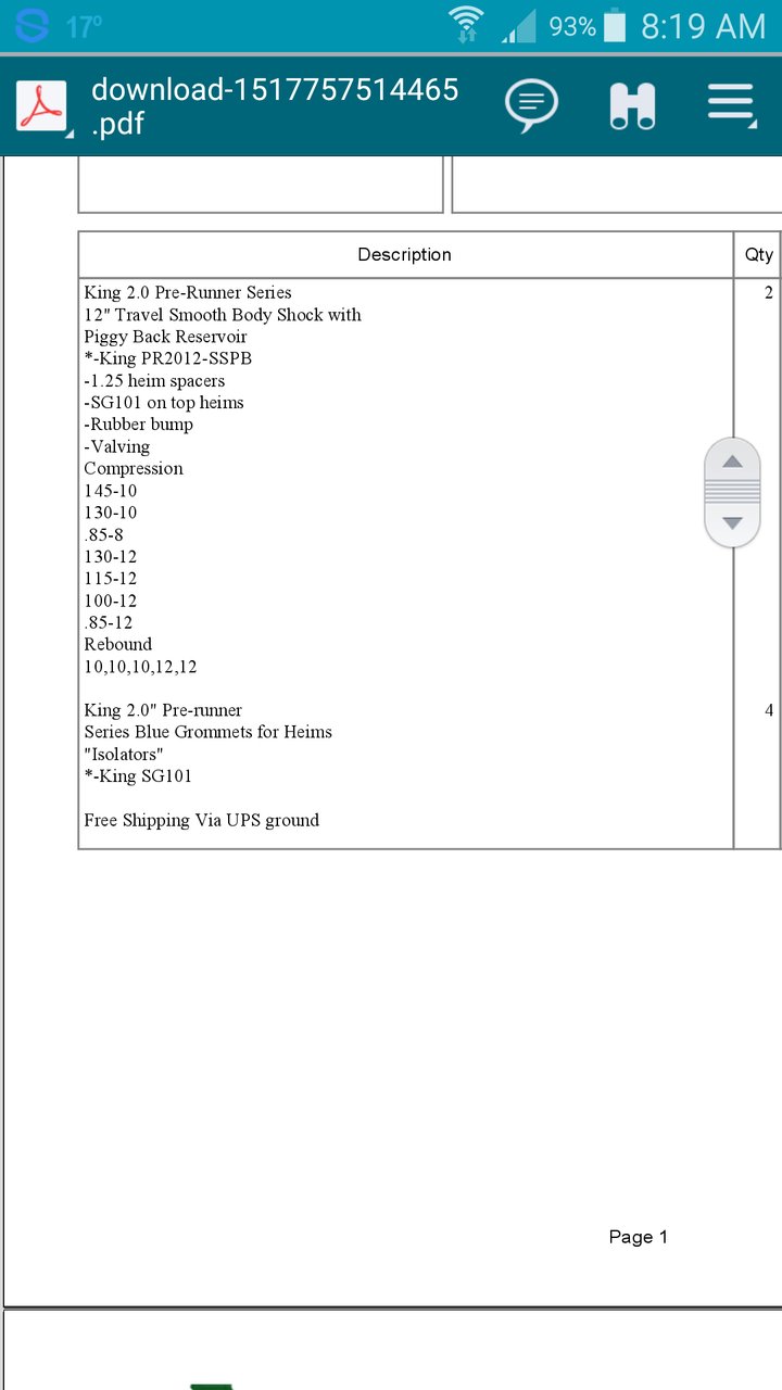

    Got my build specs! @jberry813 how'd they do? Shocks are enroute!
