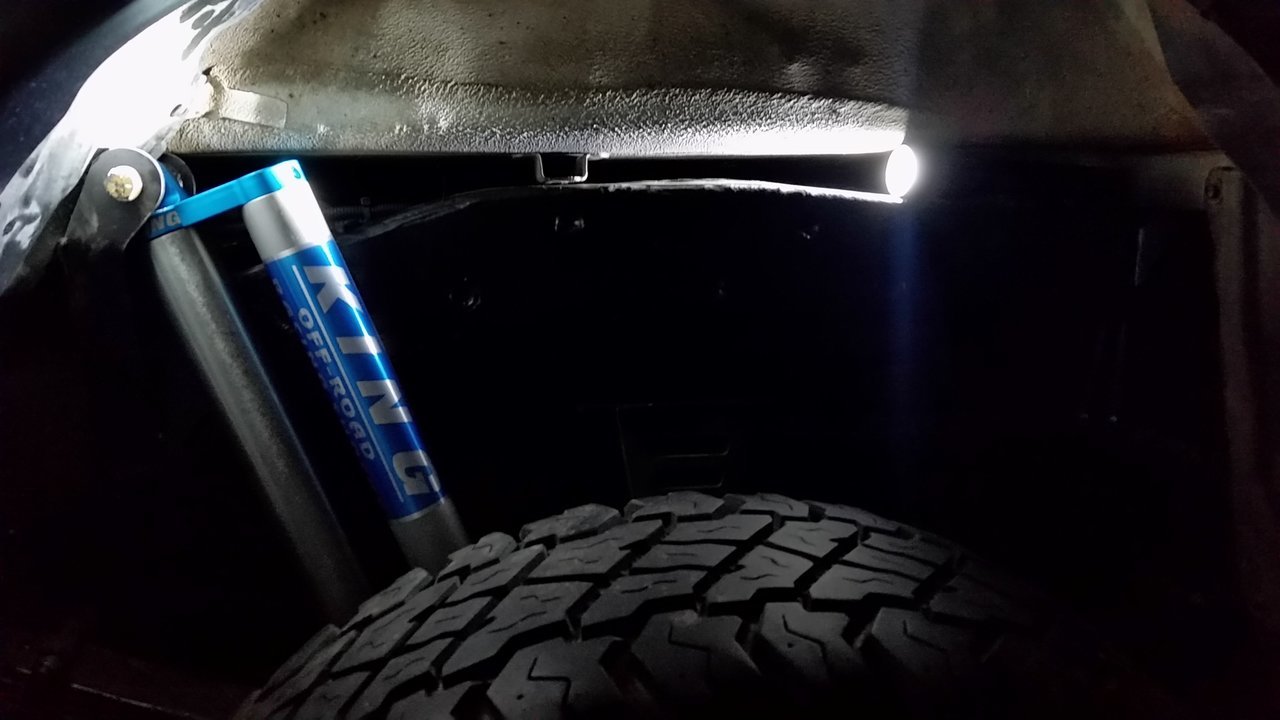

    Thats cuz it was sitting for 3 months.... just got my shocks on! Gotta work some other kinks out but nothing too bad

    hows the clearance?
  9. Feb 9, 2018 at 11:35 AM
    #1549
    Squeaky Penguin
    Squeaky Penguin Nothing Ventured, Nothing Gained
    Apr 5, 2012
    #76340
    10,082
    Brett
    Steamboat Springs, Colorado
    '01 4WD, SR5, TRD & '13 TRDOR AC
    Lots of dust and custom dents, Check Build
    In for pics of how bad your tire rubs those shiny piggybacks. :popcorn:
    Wishbone Runner likes this.
  10. Feb 9, 2018 at 11:36 AM
    #1550
    Blackdawg
    Blackdawg Dr. Frankenstein
    Dec 31, 2010
    #48500
    81,631
    Monte
    Wyoming/St. Louis
    The Trifecta of Taco's
    actually looks far enough forward its probably not too bad.
  11. Feb 9, 2018 at 6:56 PM
    #1551
    TMFF
    TMFF Well-Known Member
    Dec 7, 2011
    #68368
    2,588
    Tim
    Thornton, CO
    01/02 DCLB
    Stuff and junk and things...
    The black circular marks will be there the first, maybe second time he flex's it. I more worried about that Resi Bridge failing with no support at the end of the resi were the tire will hit it.
    @lotsoftoys Get a piggy back mount kit for the end of that resi!

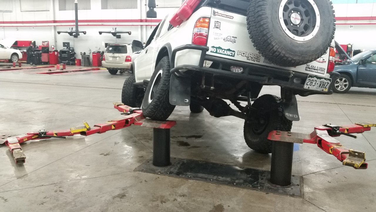

    I'm betting it don't hit, but we will see! Had to rebleed today and replace rear axle seals. Welded shock mounts and the directionsecond said the heatime could damage the seals... easy fix. Brakes feel wayyyy better. Can't wait to get it on the dirt and see how the rear bias works with front.

    Well u guys called it. It rubs but barely.... almost at full stuff. Right rear tire was starting to get lite and l/r bump stop was starting to compress. Maybe an inch more or so until the r/r comes off the ground. I think my wheels are hurting me the most but oh well. All I can do now is go to 1.5" spacers. More then that I think is kinda ridiculous. Or I could swap wheels but I don't want to. Finally just put together a set of 5... it's amazing how nice this thing rides now.
    Need to get it on the dirt! And this new brake system is bitchin too, can't wait to dial it in.
