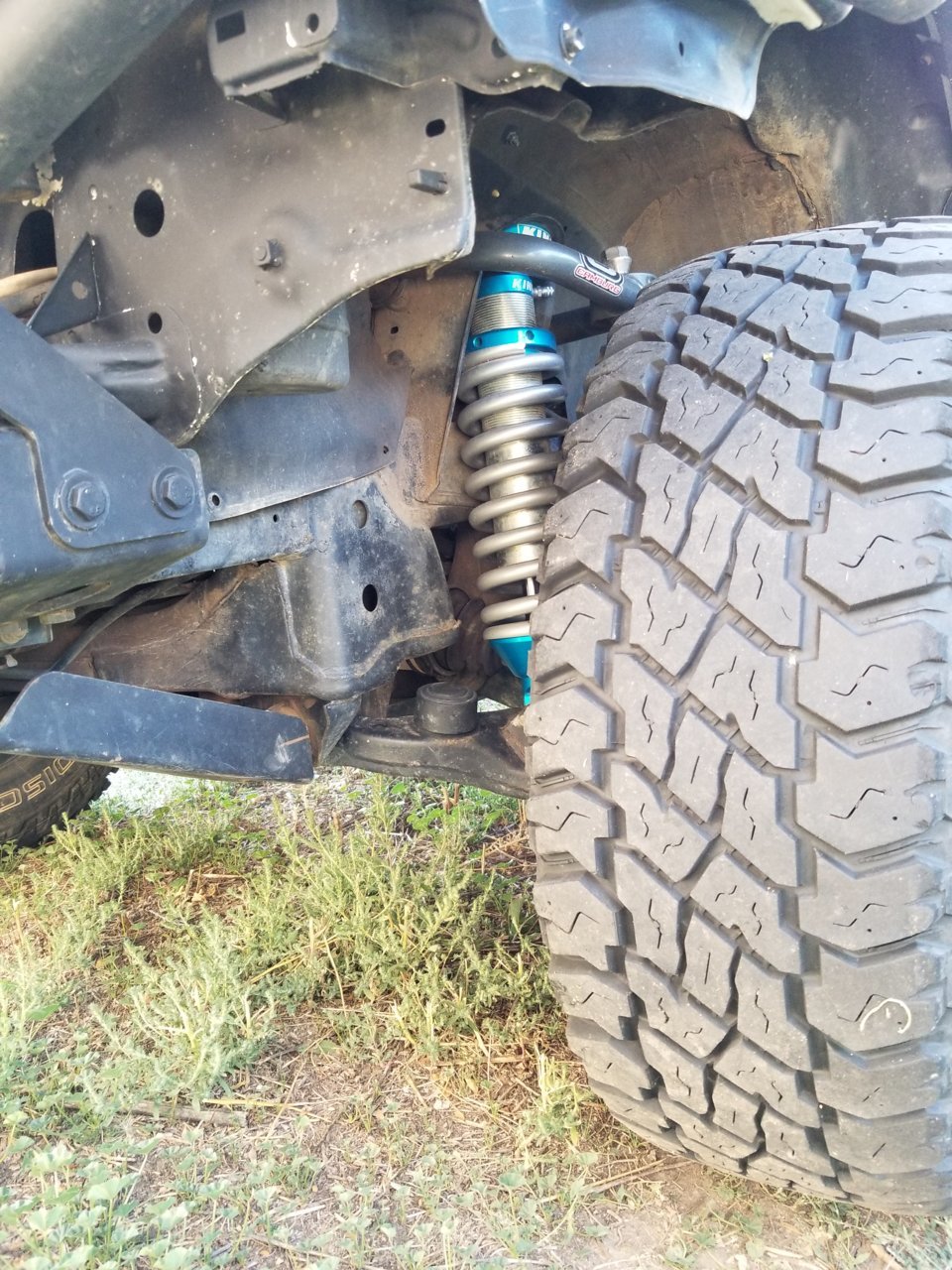

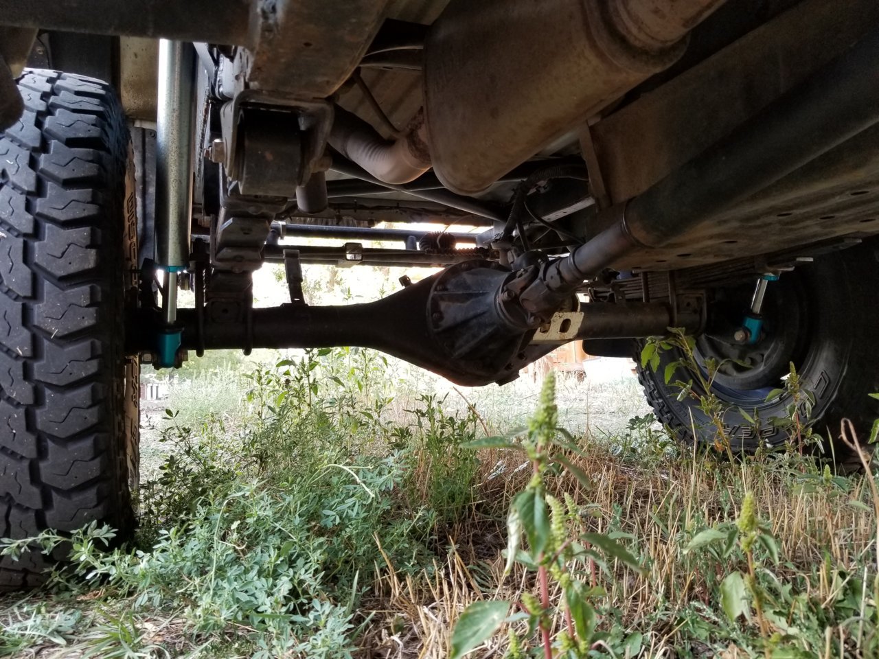

    Needless to say my new shocks got a proper intro to use:) truck rides great and handles even better. wash board still blows tho i think due to the smaller tires... lost a bolt from my light bar and damn near lost the high lift... nothing zipties couldnt fix!

    Looking good Jace. Glad the new setup is working well.
    I think mine eats up washboard really well, so guessing you could improve that with valving. Do you know if you have flutter stacks in your shocks?

    I don't think I do? I could go read my build sheets more closely... what does those do?
    Bob had a great idea of not airing down as much which seemed to help slightly... these wash boards we hit were large and it felt like the the wheel was literally hitting the humps on the trail. Aired back up to 20 and it seemed to get better. That and I went faster;)

    The stability tho man is huge. Fully loaded for camping and turning felt great in the dirt

    Take a look at your build sticker from King, there would be an F in the first series of numbers. No idea what they put in the OEM coilovers either.
    I'm not a shock tuning expert by any means, but a flutter stack allows there to be a soft section of travel, before getting into the rest of the valve stack. So good for high shaft speed, but low force, like washboard.

    Huh... makes total sense. I will look at the build sheet when I get a chance
