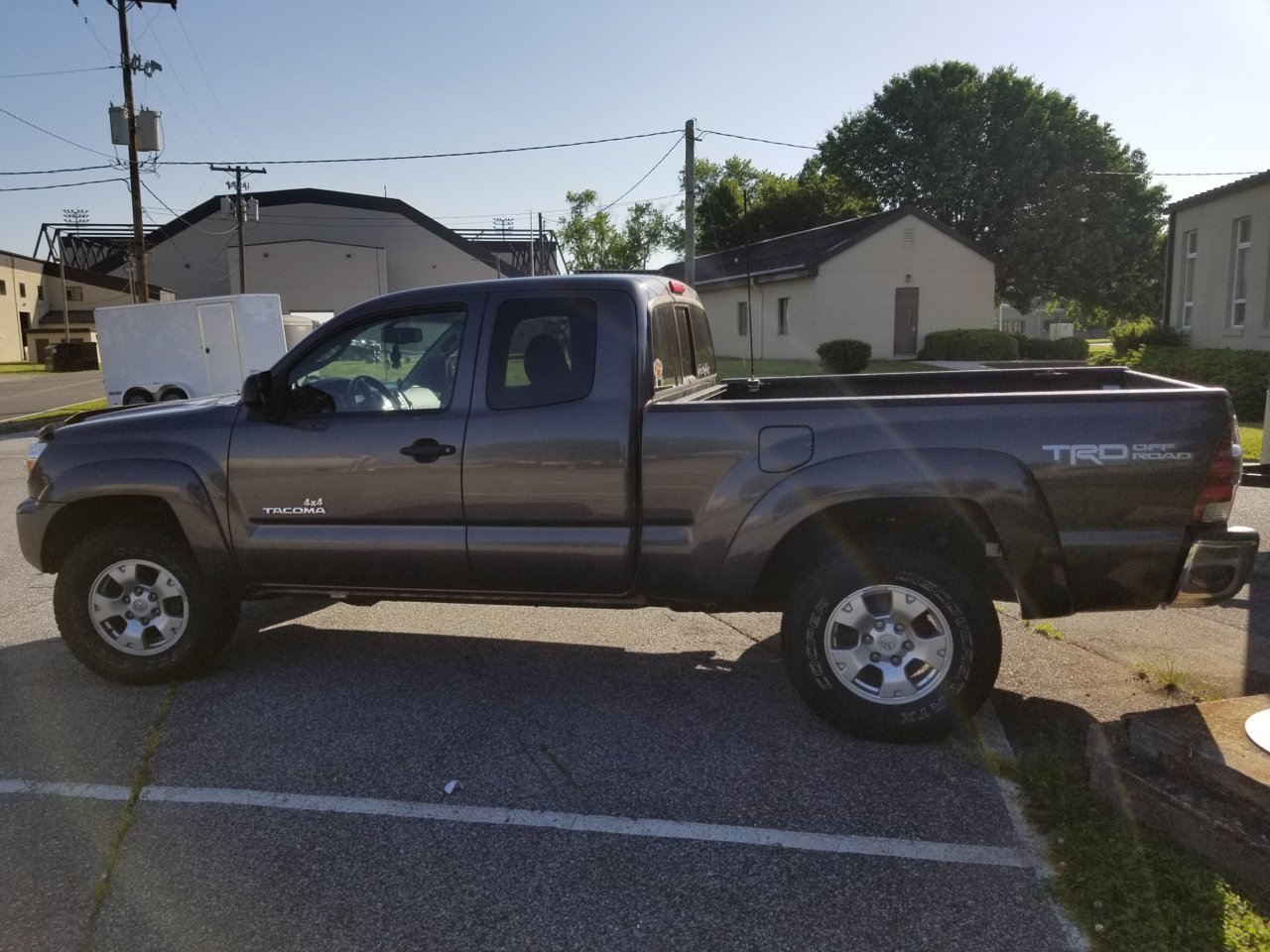

    This is the truck being rigged.

    Now that will make a lot of difference in your build.
    Personally I'd just be in planning phases now, and not touch anything until you are ready to go to that level. Unless you KNOW something you are going to do will be 'good' for current and future versions.
    You don't want to be 'redoing' stuff!
    Tires will be your #1 friend in swamps. And if your dedicated, cutting, chopping and trimming the body for fit should be a non issue. As lift isn't what actually creates clearance anyway.
    Another thing you need to focus on is recovery. Being able to winch from both ends is a real plus.
