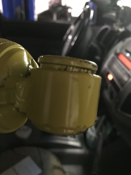

Love these bushing on OME sport shock (rear)....not
Discussion in 'Suspension' started by SpeedwayTaco160, Dec 3, 2016.
  1. Dec 3, 2016 at 3:10 PM
    SpeedwayTaco160
    SpeedwayTaco160 [OP] Well-Known Member
    Aug 25, 2013
    #111117
    1,182
    Killeen TX
    10 Sport SWB DCSB
    Just installing my OME lift with dakars. Curious where the QC is at on this stuff. Both rear shocks were like this. Def makes this a pain in the ass. Even with a c clamp these don't budge

  2. Dec 3, 2016 at 3:14 PM
    EatSleepTacos
    Mar 24, 2015
    #151688
    59,651
    Randy
    West Valley, AZ
    2017 4Runner
    Do you have a vice? That'd probably work great.
  3. Dec 3, 2016 at 3:51 PM
    SpeedwayTaco160
    Aug 25, 2013
    #111117
    1,182
    Killeen TX
    10 Sport SWB DCSB
    Will have to purchase one

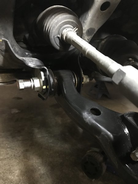

  4. Dec 3, 2016 at 6:58 PM
    SpeedwayTaco160
    Aug 25, 2013
    #111117
    1,182
    Killeen TX
    10 Sport SWB DCSB
    Have both lower control bolts lose and still can't lower control arm. Any ideas
  5. Dec 3, 2016 at 7:01 PM
    EatSleepTacos
    Mar 24, 2015
    #151688
    59,651
    Randy
    West Valley, AZ
    2017 4Runner
    It's likely your alignment cams are seized. Do you get snow where you live?
  6. Dec 3, 2016 at 7:01 PM
    Sandman614
    Oct 26, 2010
    #45273
    35,580
    Tim
    Garner, NC/Boone, NC
    '06 SR5 Off Road
    Cams are seized, probably gotta cut em
  7. Dec 3, 2016 at 10:25 PM
    SpeedwayTaco160
    Aug 25, 2013
    #111117
    1,182
    Killeen TX
    10 Sport SWB DCSB
    I got them down. I sprayed seam foam deep creep and used a 2x4. Worked perfectly. But I can't get the alignment plates lines back up to the marks I made.
  8. Dec 3, 2016 at 10:29 PM
    OZ-T
    OZ-T You are going backwards
    Dec 15, 2009
    #27584
    50,461
    Peter North
    British Columbia
    Cams are probably seized as mentioned above

  9. Dec 3, 2016 at 10:43 PM
    SpeedwayTaco160
    Aug 25, 2013
    #111117
    1,182
    Killeen TX
    10 Sport SWB DCSB
    Damn I hope not. I take it firestone couldn't replace them? I won't stress right now. I shall wait until what they say at the shop

  10. Dec 4, 2016 at 4:52 AM
    Sandman614
    Oct 26, 2010
    #45273
    35,580
    Tim
    '06 SR5 Off Road
    If you can't remove the tabs they're seized. If you got them to move with a 2x4 you probably tore the rubber in the bushing.
  11. Dec 4, 2016 at 6:17 PM
    SpeedwayTaco160
    Aug 25, 2013
    #111117
    1,182
    Killeen TX
    10 Sport SWB DCSB
    Took it to the shop and they were not seized. Pretty happy about that.

  12. Dec 4, 2016 at 6:32 PM
    Sandman614
    Oct 26, 2010
    #45273
    35,580
    Tim
    '06 SR5 Off Road
    Gonna guess the rubber in the bushing is torn now.
