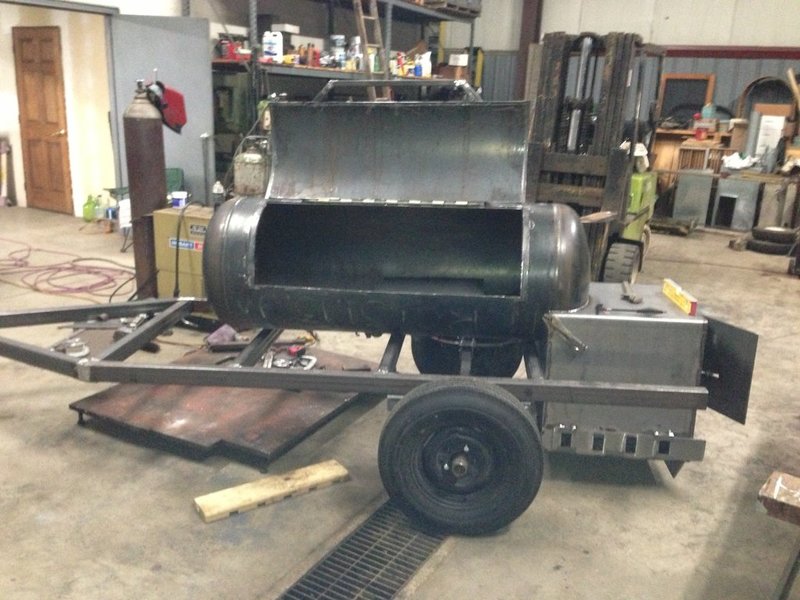

    I used a 120 gallon propane tank... 1/8" is plenty. Most guys are rolling tanks due to cost and availability. Try to incorporate a way to change the angle on the tank. That is how I change temps from end to end.

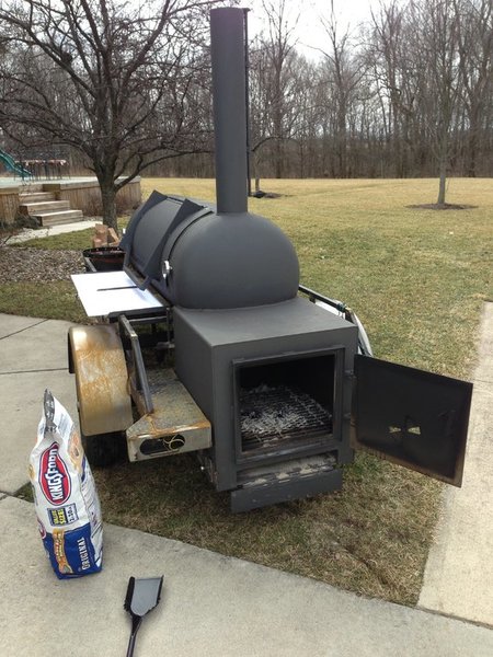

    yep. That was version 1.0, we later added the warming box. I would stick with the 4' cooking grate. It is materials friendly, and allows the smoke to roll on the far end and there is a lot of heat directly above the firebox end. The air inlets have to be a certain size and the hole (semi-circle) cut between the firebox and the tube is critical for heat flow. I also added a second rack in the top of the tube. It too is a drawer. We don't always use the second shelf, but it is nice when you need the extra space. It takes some planning to get what you want on the first try. Flow rates are pretty critical for low and slow. My pit literally purrs between 200-300 depending on what you are cooking. My temps are identical across the rack from left to right. No hot spots and never a grease fire

    Notice the second drop down door on the fire box... That is the ash pan below the raised fire grate. It truly took a lot of time and planning, but it is the ultimate pit!

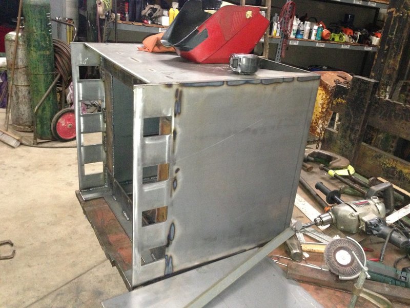

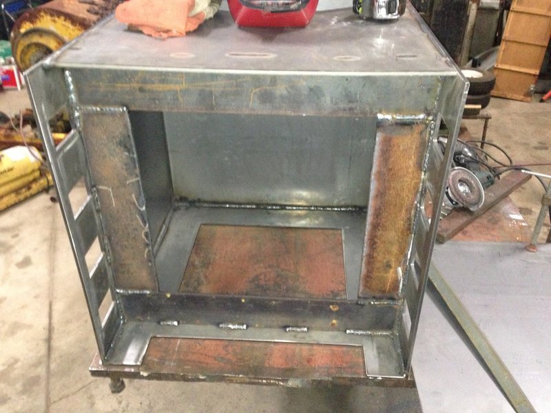

    By the way, 1/4" plate for the fire box, 3/16 for the warming cabinet. It was just easier for me to build the trailer from scratch. I have a 250 gal tank that is calling me to do it again, but I am perfectly happy with what I have. My buddies want to go bigger, but it is always my dime, and my time if you know what I mean. I have too many other items on the bucket list to re-do this one.

    By the way, the gussets on the door need to be welded on before you torch the hole for the door. We literally had to drive the forklift onto the warped door to straighten it. Torches do weird things when you least expect it.

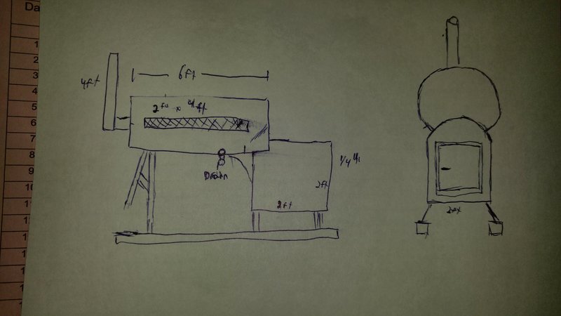

    Heres what i originally had planned. Simple. Do you just put a bowl of water in when you cooking?

    Got a buddy who works at the tank factory. Move your stack to the other end and put it through the top of the tank in the corner. I will tell you that reverse flow is the only way to go. It will work if we crunch the numbers and you won't be sorry. I would try to Weld it to to a skid or at least put casters on the bottom to move it. The magic of the trailer is that the party (and the mess) go to someone else's house. Keep in mind that it costs about $350 to light this thing off with meat, beer, sides, and snacks. It's nice to provide the smoker for the party and let the host pick up the tab. When it it at your house, it's your party and your $$$$. No water needed to cook. The reflector plate keeps everything indirect. We use a lot of foil.
