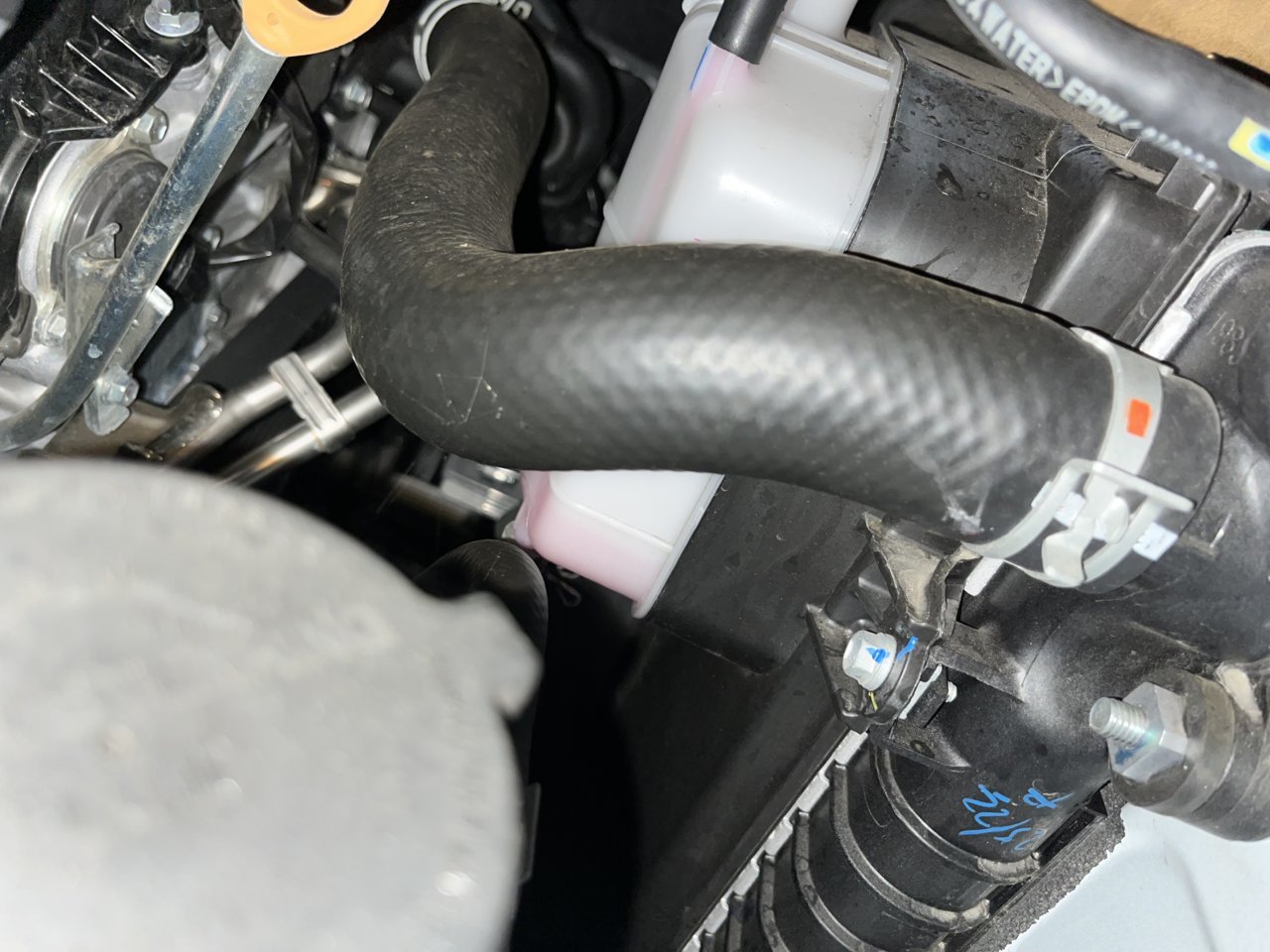

  5. Dec 5, 2022 at 6:46 PM
    #25
    danny15l
    danny15l [OP] Well-Known Member
    Jun 5, 2022
    #398781
    361
    2022 white Tacoma TRD sport MT
    nada
    Hey guys I’m back again. 8200 miles on the truck and the reservoir is at the low mark again. Filled it to the top line last time at 4000miles.

    Pics ?
