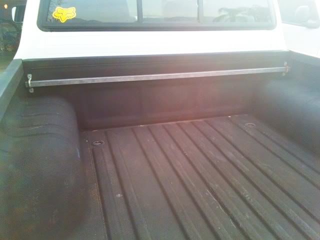

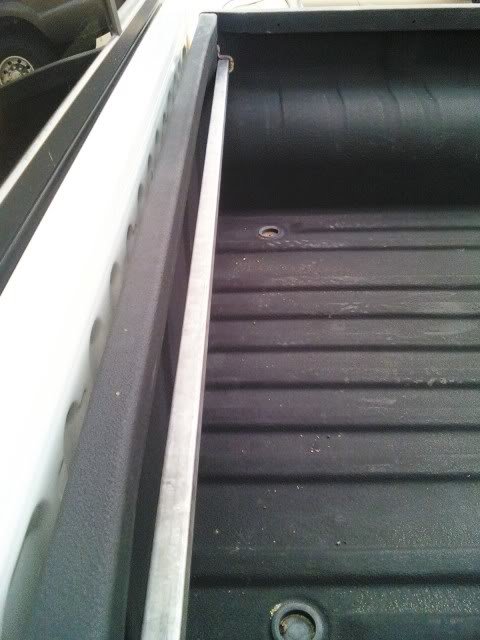

    Did you get something yet? I just started to make a rack for my bikes tonight. I bought a piece of 1" steel square tubing from home depot, cut it to 57.5" long. Then Took the two tie down hooks off near the cab side, used an angle grinder to grind the inside of the tie down hooks so that the tubing would fit. Then bolted the tie down hooks back in. It fits like a glove, and wont interfere with any thing I haul in the bed. I just ordered a couple of fork mounts (hollywood mounts, $6 each on Amazon), then I have a can of that "bed liner" spray that I'll shoot on it to keep it from rusting, and to make it look like part of the bed. Total cost for the rack will be $30. I'll post pictures once the fork mounts arrive.

    Fork mounts will be on top of the steel bar, then I'll spray the bar and tie down hooks with rattle can "bedliner". $ 30 total for the rack
