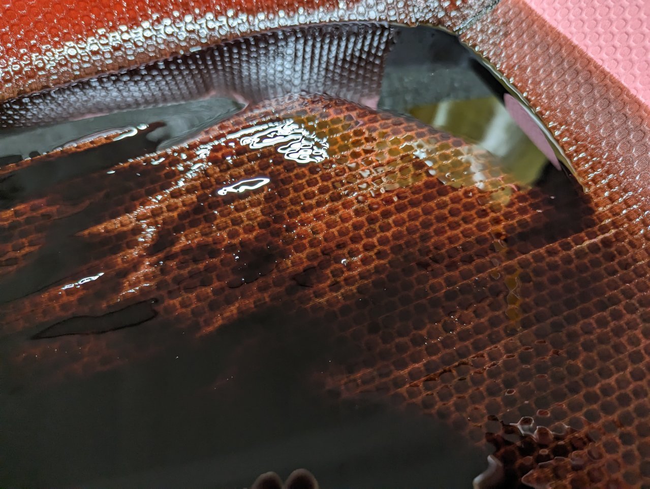

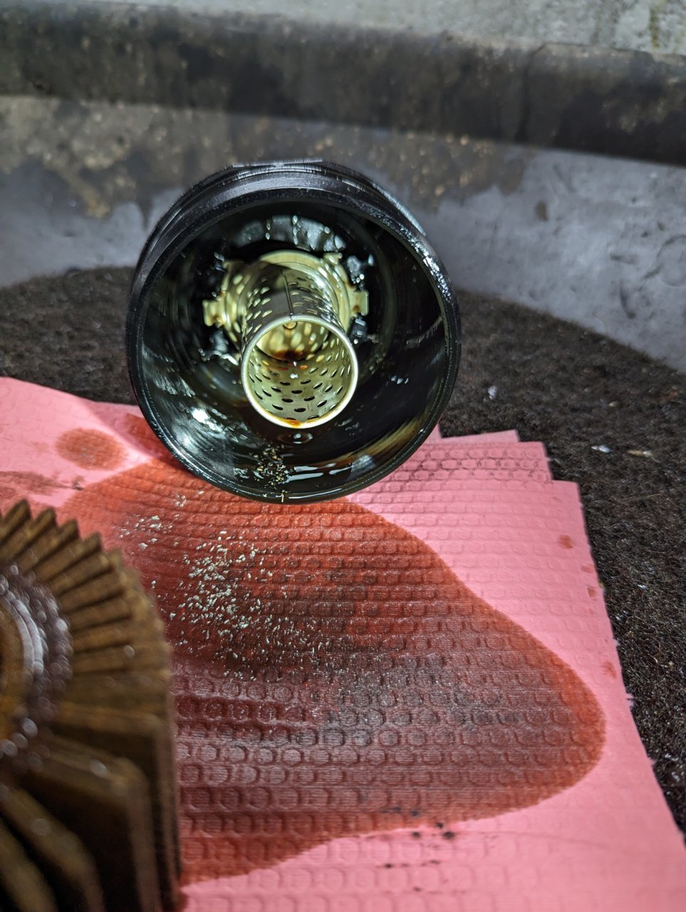

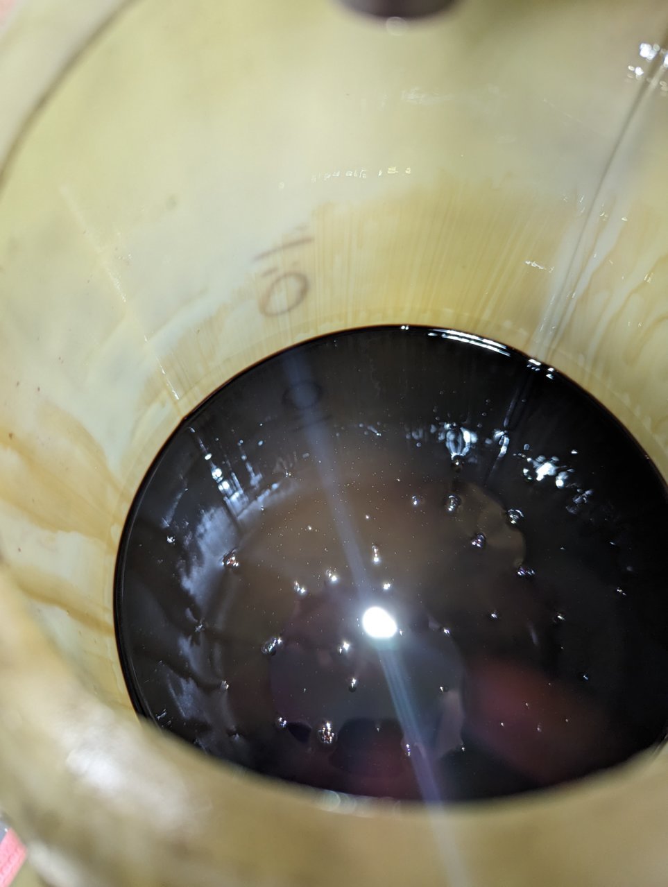

    Yeah, spoke to Toyota today. They said since it's out of the standard and power train warranty even if they would offer assistance via goodwill I would have to pay the "majority" of the cost. That is only after I pay the $3,400 tear down and diagnostic to determine the failure. They offer no assistance with that either.
    Quoted engine replacements and the best I found was $10,800 install with a 17k mile used motor.
    Dealer wanted $15-16k for a 55k motor, another shop wanted $18k with a 80k mile motor lol, and a 4th shop wanted $14k for a 55k motor.
    Still on the fence on what I want to do.
    Leaning towards replacing it with the low mile motor for $11k.
    They drained the oil out the truck and the filter and i got a few more pics.

    If it were me I would remove the timing cover and take the oil pump apart. Can’t hurt anything if the engine is already trash and you could get lucky and find the metal came from the oil pump. It would also give you an opportunity to see if the timing cover leak repair was done properly or if it was the root cause of the oil pressure problem.
